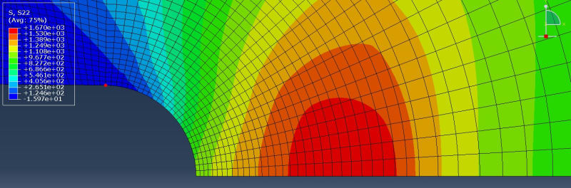

Hi
I am analysing crack-tip to study thickness effect in Elastic Plastic fracture mechanics. Here I have taken two TPB specimen geometry with a/w 0.3 and 0.5 with 10mm and 2.5 mm thickness. I have used 'Tool-Midsurface-Assign thickness and offset' option to specify thickness rather than 'using 'Plane stress/strain thickness=' option in section. I have also given thickness 'from geometry' in 'section assignment'. 4 different input files were created. I used CPS8R plane stress element. but in the result, I get the a/w effect in crack-tip stress-strain analysis and not thickness effect (result in both thicknesses are same). I have attached a pdf with the input file of a/w 0.5 with 2.5 thickness for your reference. I suspect, I have committed some error in my abaqus analysis. Kindly help me in this regards.
Taking the geometric thickness is only possible for shell elements. You are using 2D solid elements. Enter the plane stress/stain thickness value manually in the solid section menu.

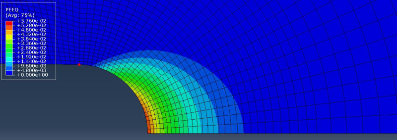

As per your advice, I ran my analysis in 2D solid with CPE8R plane strain analysis on 20,10 and 5 mm thick specimens of a/W0.5. Plane stress/strain thickness in section is also assigned. I expect decreasing S22 at the crack tip (at the same CTOD/CMOD) as thickness decreases, but i got same stress at all the thicknesses. inp files for 10 mm thick is attached herewith. need help please.

I am studying the constraint effects in fracture. I took different geometries to evaluate crack-tip constraint parameter 'Q'. The constraint variables consists of geometry of the specimens, a/W ratio, loading modes and B/W ratio. B/W ratio involves thickness effects. The critical fracture toughness increases when thickness of specimens decreases and stress-strain field in crack tip start changing to plane stress state from plane strain state. As thickness of the specimen decreases, tri-axial stresses loss their dominance due to out-of-plane effects at the crack-tip. This becomes two parameter fracture mechanics. lot of literature available on the said topic. I wanted to simulate the crack-tip stress fields (particularly Syy for quantifying 'Q')using abaqus to check all these constraint variables. Though I specify the different thicknesses in Plane Strain or Plane stress analysis, abaqus gives same results neglecting B/W effects. How to get in-plane as well as out-of-plane effects using abaqus if CPE or CPS elements doesn't work for out-of plane effects? IS 3D THE LAST OPTION??

In my opinion you need to use plain stress elements to model the different specimen thicknesses, and, both material (plasticity) and geometry non-linear effects should be simulated. As the load increases, you must be able to see the stress rising until it reaches the specified yield strength, where after the rise in stress becomes much slower as the material yields locally (relieving peek stress).
Regards
After literature search, It is concluded that 3D is the final option for evaluating both in-plane and out-of plane effects at the crack-tip. Thanks Mustaine3 for good discussion.
