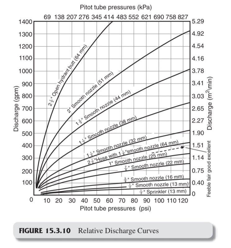

Interesting to read. SprinklerDesigner2 hopefully you never had issues there.
One thing I would like to note though, mainly for my understanding, is that the 149 psi for a standard 2 1/2" hydrant butt (refered in post Nr 8) is understood as the pressure difference exerted on the hydrant alone, which means practically 149 psi in the input of the hydrant since always flowing to the atmosphere. In the 6th post however, it seems that the K factors cited are derived from the entire pressure loss between water supply and hydrant outlet, not just the hydrant itself and therefore the factors should not be directly comparable.
Am I getting it wrong?
OK so after doing some research the k factors seem comparable since the residual pressure is measured on the hydrant just before entrance to the opening. Got confused by typical pump curves.
Side note, NFPA fire protection handbook has graphs of various orifices including those of fire hydrants and it seems the k factor for a 2 1/2" outlet hydrant comes to an around 180 for most of the pressure range shown. I guess relying on a fixed K factor for any 2 1/2 hydrant may not be the most reliable approach.
