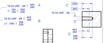

threaded hole depth feature of size?

IF I OVER SIMPLIFY There are two approches to dimensioning : one for feature of size and the other on for the rest. Feature of size are feature with two opposed surfaces. hole depth, in that sence are not feature of size. direct tolerancing on the dimension is used on FOS dimensions. everty thing else is controled with geo tolerancing.
in the case of threaded blind holes, there are the thread depth and the tap drill depth. I could imagine using geometric tolerance for neither. I can't find a clear way in y14.5 2018 nor y14.6 2001 to show HOW to tolerance the said depths. can you help? I'm including 4 choices to tolerance the depths.
It is pretty rare to try to tolerance the extent of threading because that normally is a function of the number or extent of full threads for which the typical concern is that there are enough of them, a minimum. There is less concern over the depth of the tap-drill diameter as the mating screw is assumed by convention to reach no further than the extent of the full threads. The tap drill diameter is only an artifact of the thread tapping process as is the presence of a conical feature at the bottom.
Were one to weld a fully threaded bushing to a flat plate, there would be no tap drill diameter or conical feature and only the number of full threads not affected by the weld would be of concern.
Is there a mechanism you are creating that requires a particular range to the angle of turns of full thread that you are controlling with the extent of full threads?
Normally the satisfaction of setting the max depth of the tap drill/the operation that creates the minor diameter, and the minimum amount of full threads is enough. Whatever overlap there is doesn't matter to the function of the threaded feature.
I guess you could use profile to avoid ambiguity but you'll be frowned upon for an "overkill". Y14.5 and most "GD&T" trainers don't want to be frowned upon but they don't want to show ambiguous examples either so they don't show any tolerances for hole depths, chamfers, etc. Y14.41 possibly had no choice.
I call out the tap info, and leave tap drill size up to the machinist. Then, use basic rule of thumb that I have always used "basic rule: the tap drill depth should be at least one thread or one pitch beyond the chamfer of the tap".
If there is a clearance issue, then I call out drill depth.
Well, each feature shall be toleranced per ASME Y14.5-2018 section 4.1 (a).
Also, direct tolerancing on the dimension is NOT exclusively used on FOS dimensions.

For Example D I would put .380 Min full thread and put .599 Max This way the manufacturing can figure out their best approach.
I like to call thread depths out on sections, as in Example D. This way it is clear to the person using the print.
We do not call out the Tap drill. Unless there are other certain design considerations.

@3DDave, I was preparing an example in what a good GD&T drawing should look for my students and, like @Bunrunduk said, I didn't want to overkill my dimensions but i don't like leaving things ambiguous: I first learned GD&T from experimenting with bad parts made from bad drawings.
@Bunrunduk, I like the 14.1 solution because if I see an inspector checking the form of the unthreaded portion of the hole, i'd fire them for waisting time and money.
