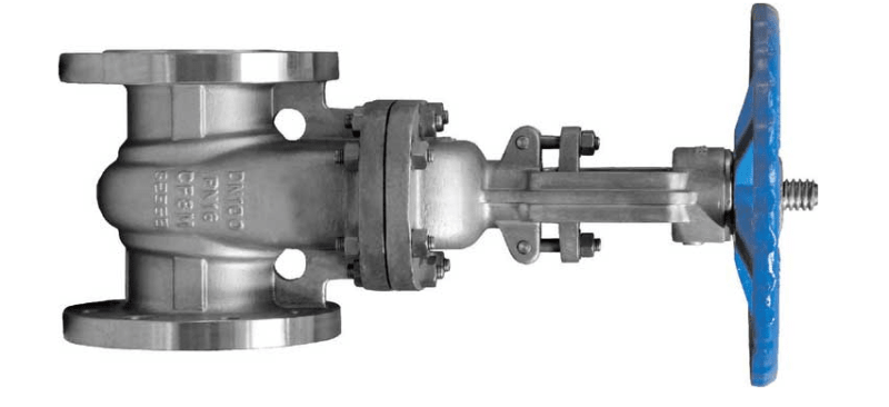

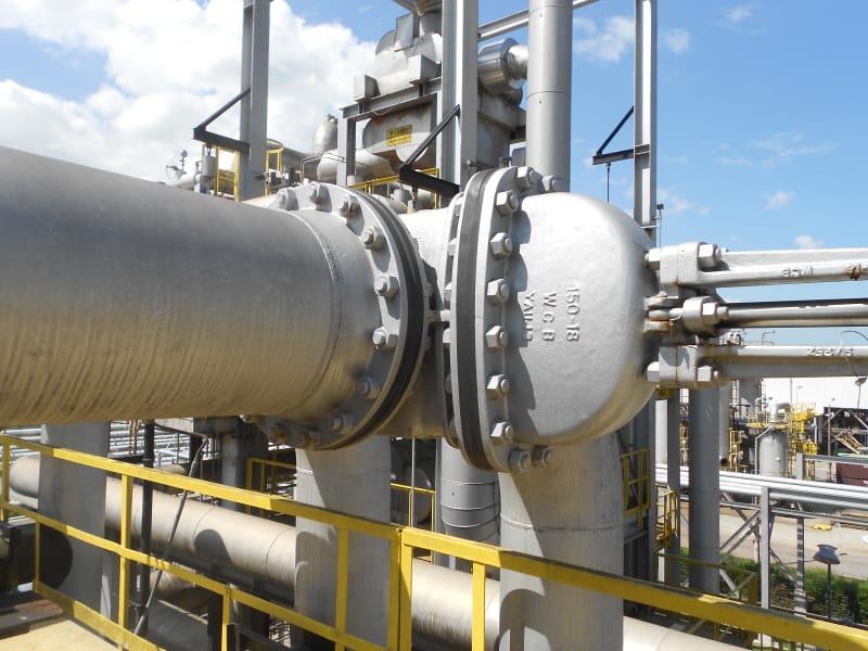

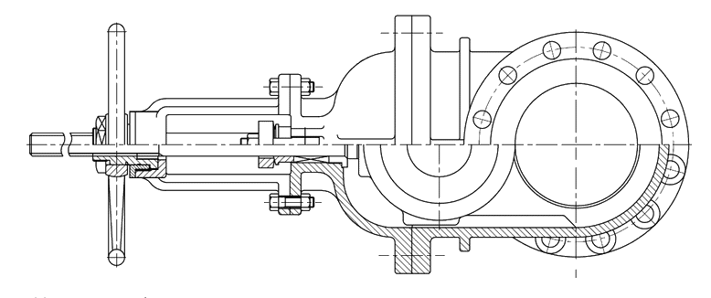

Dear All, I have another small query, with regards to the position of the stem of the gate valve recommended to be in horizontal position specially in flare systems where if the failure of the step would endanger the wedge to fall off down causing blockage of the relief path. My question is, I need to visualize how a valve installed in horizontal plane along a horizontal flare piping would have its stem / plug in horizontal position , is the above statement means that the valve shall be installed in the vertical plane of the piping system i.e. in the pipes descending/sloping downwards such that the stem would be perpendicular and considered in horizontal position and hence it would not fall off the gate causing obstruction?
Could be mounted with stem horizontal in a horizontal pipe or stem horizontal in a vertical pipe.
Up to you.
But you need to check with the vendor that it will work properly in that orientation. Not all of them do.
So like this
or like this
Thank you so much Mr.LittleInch,
Is the first figure representing a horizontal pipe position.. I am unable to visualize how the stem/spindle in horizontal position can be shown for a valve installed in a horizontally oriented line.
Can you please help?
If it is a piping isometric or a P&ID, you may add a note to specify that the valve's stem should be in the horizontal position.
A real application on a PSV discharge line:
Daniel
Rio de Janeiro - Brazil
Yes, but Daniels photo is much better - I couldn't find one on line or in my collection so just chose a drawing.
But you really need to get the valve suppliers buy in as it is not normal to do this and sometimes the valve might need some extra guides or it might be harder to close.
