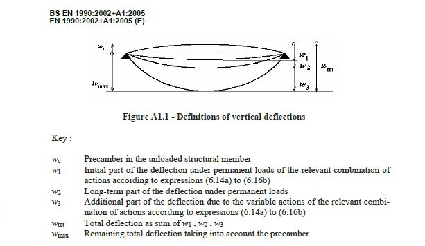

Deflection calculation is time consuming IMO , we should say deflection prediction rather than calculation. It should be limited to avoid cracks at walls and tiling etc..

It is a structural engineers duty to suitably protect the non-structural parts of ther buildings from damage that would be caused by anticipated deformations of the primary structure. Some strategies that we use for that include:
1) Isolating the non structural elements. Slip tracks at the top of cold formed stud walls and stuff like that.
2) Designing the primary structure to be suitably stiff that it does not tax the non-structural elements harmfully. L/600 etc, absolute deflection limits etc.
3) Taking advantage of construction sequence where appropriate, acknowledging that non-structural elements only care about the deflection that occurs after their installation.
4) In rare situtaions, designing the non-structural elements to be what I'd call pseudo structural. In many parts of the developing world, I feel that CMU infilled masonry buildings create this situation. And that sometimes begets the seismic problems.
In fact, I consider protection of the non-structural building elements from damage induced by the primary structure to be one of the key aspects of structural design. Life safety trumps all else ethically but it's usually serviceability problems that land in hot water with your clients or -- worse -- they're lawyers.
