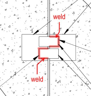

To illustrate OP's situation:

The detail posted by dold is the connection we have drawn for all of our tilt-up projects. There are no objections to the detail other than the contractor does not want to have any connections, loose or fixed. He stated "most engineers" say that no connection is necessary. I am looking to see what "most engineers" think about not having any connections at the panel edges, other than corners.

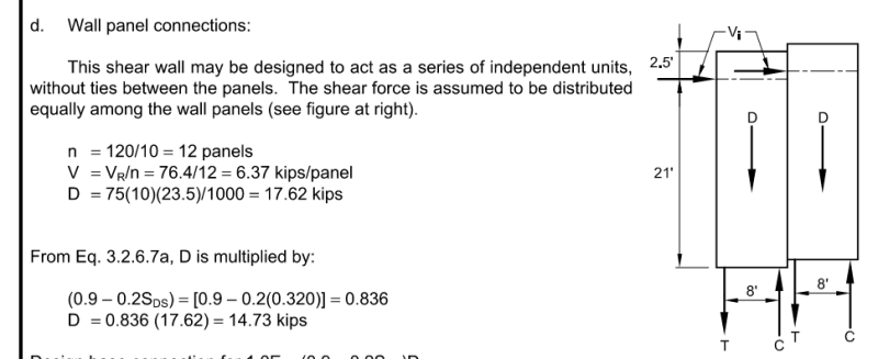

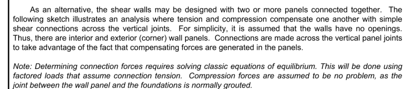

PCI Handbook on design guidance on wall panels with connections and without connections. Sorry dold, they are using FBD.

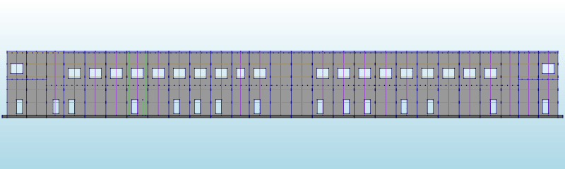

I don't find the PCI example overly helpful except for the very rare case where the wall has not been butchered by archs. The wall lines we see usually look like the image below. The topic of determining connection forces is very poorly covered in my view.

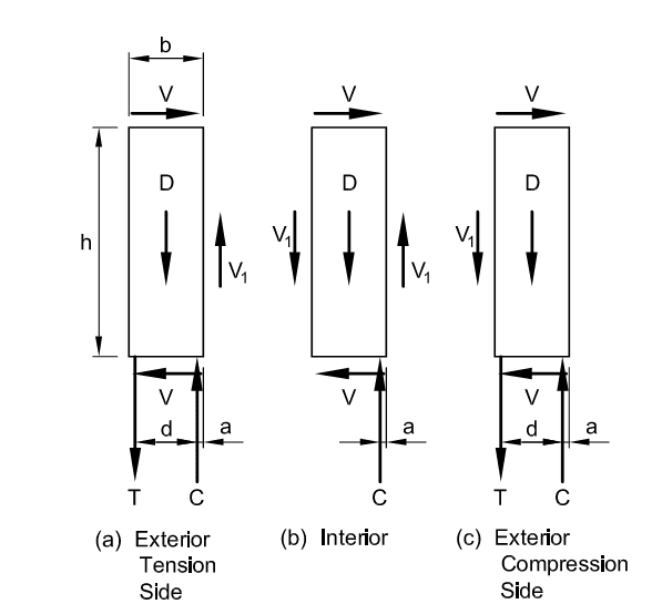

Brad: Agreed. PCI does not cover connection very well considering the importance they play in precast. However I assume you use the second method in PCI for analysis since you appear to have the panels connected and the openings centered in the panels.
