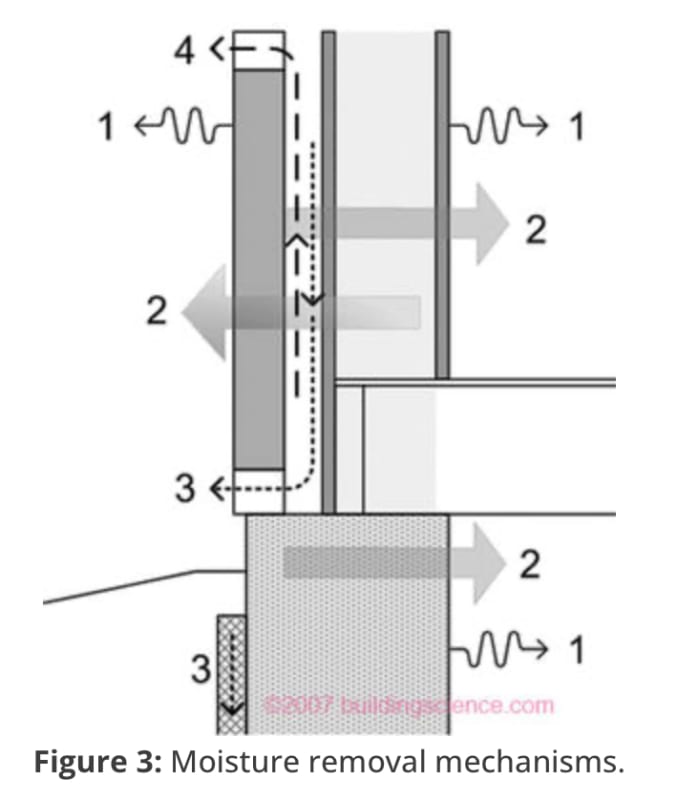

The wall detail I'm thinking of is as follow's, I do not think it will give moisture problems. I will likely leave the panel joints open, to allow for drying. There will also be a wrap around veranda, so there will be no direct exposure to rain. [URL unfurl="true"]https://res.cloudinary.com/engineering-com/image/upload/v1703549400/tips/Note_26_Dec_2023_at_10_17_47_am_copy_lpide1.pdf[/url] Note: I left off structural details for clarity. The panels will be stable from roof bracing.
Now that you have an interior frame wall,, it makes mle\re sense because insulation has a place to live.
That assembly would somehow need to address getting bulk water and vapor out of the gap. Below is a diagram from Building Science Corp with a similar concept.
Assuming you’re in a much colder climate if you have a vapor barrier.
