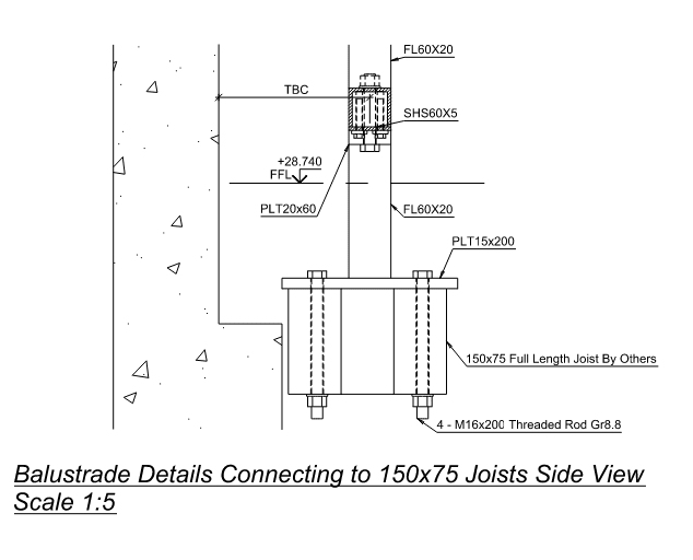

How do you rationalise these types of balustrade connections?
Source:
Withdrawal strength wouldn't be an issue, but I thought you need 5d edge distance for shear.
How about torsion - is this nominal and taken out by joist end connections and nominal stiffness provided by the dummy joist?

My contractor's engineer keeps showing this nasty connection, but refuses to provide any calcs; "timber by others". Certainly their connection doesn't work, because they've forgotten to provide a washer...

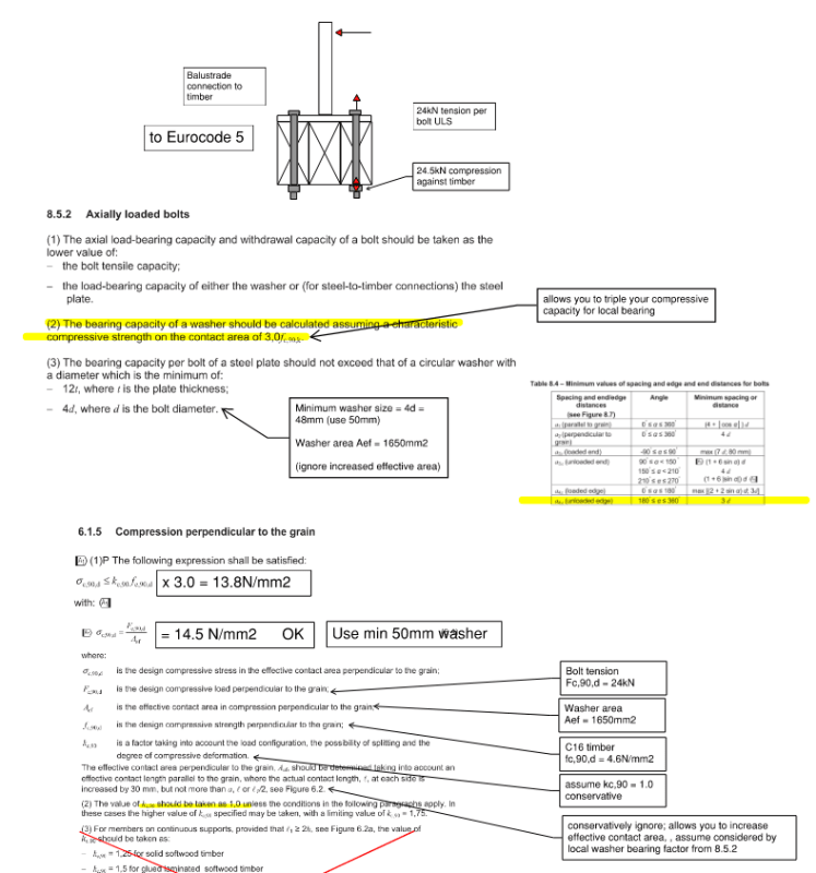

I went down the rabbit hole anyway, more out of curiosity than anything. These are 4-bolt baseplates @ 720 crs, with a 1.5kN/m live load 1.8m high. I am operating in the UK and ran this calc to EC5, looking at compression in the washer. It looks wrong, but because the EC allows you to triple your compression strength with a washer, this connection barely just works.
Shear is ignored - with a 1.5kN/m line load this works out to a negligible 0.4kN per bolt. Maybe need to look at 1.5kN point load, eh.
Coach screws I can't figure out - while you can just get enough withdrawal strength, you'll never meet minimum edge distance requirements for axially loaded screws (given in EC5, can't find in NZS3603?) - and I believe then you need to reduce your capacities. I think they are only suitable when spaced at close centres.
I'm not saying it necessarily meets code, but I think I like the bolted connection better. It definitely needs a decent sized plate washer, though, like you noted.
