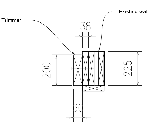

I want to install a timber trimmer flush with the face of an existing external timber wall. Should I size the trimmer based on the spacing 900mm if I fix the trimmer at 900mm spacing? for example, as continuous beam 900mm each span?
Would you recommend using screws or bolts for fixing? If the shear force is 2kN and the tensile force is 1kN. The timber trimmer is intended to support floor joists for a new extension.
Please let me know if I am missing something to consider?

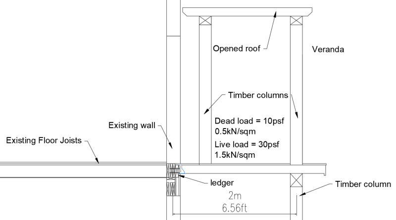

This is done all the time. Things to consider are flexure of the trimmer (ledger) between fastener points, fastener strength (going through sheathing?) required joist bearing etc. However as it appears to be a load bearing element, I would say that this is a life safety connection and should be designed by a qualified professional. There have been many a failure, lawsuits, and even deaths due to bad ledger connection details.

Based on my calcs, we have 0.5kN/m dead load and 1.5kN/m Imposed load. The new trimmer is 50 x 150mm. So the shear total load is 2kN/m times the bolts spacing 600mm which is 2kN/m x 0.6m = 1.2kN shear.
Also, working out the tensile force assuming the load applied at 50mm from the new trimmer 2kN/m x 0.05m divided by half the depth of the trimmer 150mm/2. This results in 1.33kN.
The shear capacity of M16 bolts to connect the trimmer 47mm with the existing 38mm thick would 2.569kN which is greater 1.2kN.
I am not sure about the bolt tensile capacity surely cant use 70.3kN.

This connection is a little awkward. I should also check the lateral load carrying and splitting capacity. Connecting a 60 x 200mm trimmer with M16 at 600mm spacing to existing 2x38x225 joists will fail in the shear plane.

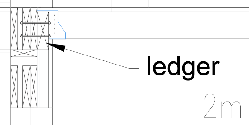

Yes it is external floor and I considered service class 3 in my design. I am not convinced with screws, it just about working using bolts. I only managed to work it out using M16 bolts in 2 rows, so that is the only way it will work. However, I am not sure how the contractor is going to close the bolts. Any thoughts?
If your detail is accurate and they used a double rim with a band joist then the access to the bolts is pretty obstructed. I think if your feeling off about screws you aught to look more into the standard practice. Screws have good performance for this application which is backed up by testing.
Here is an example [link LINK]https://www.deckbuilderoutlet.com/simpsonledger.pdf[/url]
I suppose if your adamant about the bolts you could bore out that band joist to make an access hole at your bolt locations. Big enough to fit a decent plate washer, nut and driver into. Then some chap has to stand outside with a spanner and hold it while another closes it from inside?

OP - can you expand your detail a little? I'm not really sure what's going on. Is that a beam in the wall? A header over a window? What's on the other side? Open space, a floor system? Unless we know a bit more about the rest of the circumstances and potential restrictions, span of the new floor, proposed loading, etc, we won't be able to make any constructive contributions.

whats below your proposed ledger? it seems something is there or could be added to go down to the concrete foundation. Can you add a blocking in there from the interior? then you can use screws and still sleep at night.
I'd be using heavy duty screws on this all day long. I have one architect I work with that refuses to allow bolts - he thinks the waterproofing details work better with screws. That's his game, so I won't argue. But screw installation is faster and easier, and there's significant testing that shows that they are reliable when installed correctly. Considering you probably can't install bolts correctly here, you need to either pick a fastener that can be installed correctly or expand your scope of work to dismantling more of the building to make bolts work.
