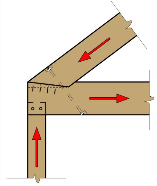

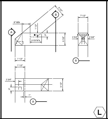

Traditional joints use a birdsmouth or some other beveled cut to allow some of the rafter thrust to bear on the notched face of the bottom chord.
Modern connection designers use the timber screws as shear reinforcement to resist the potential block shear/longitudinal shear failure mode (even if the bearing capacity calcs out).
The image below is from Jim DeStefano's timber connection presentation, which I would highly recommend (the red dashed line was added by me):

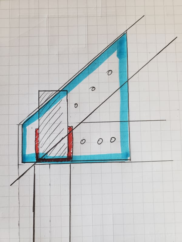

Again, assuming that the beams don't need to project beyond the truss, I feel you could do something like the attached. The blue outlines the extent of the gusset plate at the joint, and the red is a saddle. This saddle could alternately be a T-shape for a hidden knife connection with a bottom bearing plate.

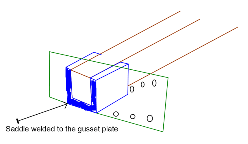

Is this what you mean below welding the saddle to the gusset?
