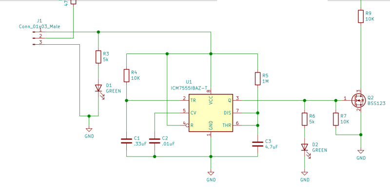

We have a circuit where a 5V control signal is used to turn on a MOSFET. I'd like to add a circuit in between here that, when the control goes high, the output signal that our MOSFET controls goes high for a prescribed amount of time (~5s) then goes back low. I have a circuit drawn that I think has some promise. I borrowed heavily from online resources. But it seems like a bit much, so I wanted to throw it out there to see if anyone has some other/better concepts of how to do this. Thanks in advance!
p.s. Vbat in the schematic is 20-30V, 24V nominal.
