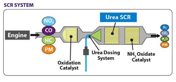

Aftertreatment systems, like diesel particulate filters (DPFs) and selective catalytic reduction (SCR) systems
