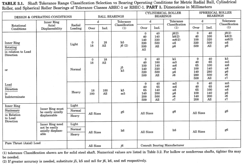

As BrianE22 above stated, the only approach I know (and perhaps others know other resources) is to use the manufactures published design rules for tapered bearings.

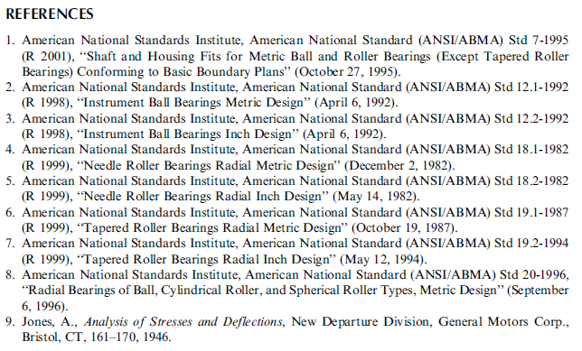

Just to leave some extra info, non-tapered bearings have a much more straightforward approach. "Roller Bearing Analysis" by Harris is, as far as I know, the Bible for such things. It contains a lot of information though. Ch 3 is titled "Interference Fitting and Clearance." which is probably of most interest to you. Below is a table from the chapter (really from ANSI/ABMA), which is specifically for ABEC-1 bearings. Also below is a reference from the chapter which contains ANSI/ABMA standards for bearings, which may or may not contain info on higher precision bearings (I've never looked into it). I tend to use the table shown for ABEC-1 without problems, but my applications are not nearly the speed of a lathe.
And to just close the loop on your overall question:
Runout is not primarily determined by bearing fits (though improper fits will certainly cause issues). The type of chuck used (3 jaw vs 4 jaw) and designs in the lathe that allow for adjustment/calibration is what really contributes to reducing runout. This is typically done with a dial caliper (which I assume you will use for your tests) and based on the read outs over the length of the test bar will tell what adjustments need to be made (this is where 4 jaw chucks really shine, link below). Doing such adjustments/calibration is done on all fabrication machinery, such as a mill which is called "tramming" which ensures squareness of the cut to the workpiece.
