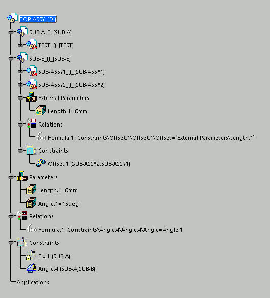

harlowmatt
Aerospace
- Nov 11, 2014
- 71
Hi all,
Is there a way to link a parameter on the top level of an assembly with a constraint such as an offset constraint or angle constraint on a sub-assembly so that you do not have to dig down to the sub-assembly to change the offset value? Also, same question about a top level assembly parameter tied to a top level constraint for the same reason. Thanks for any help.
Is there a way to link a parameter on the top level of an assembly with a constraint such as an offset constraint or angle constraint on a sub-assembly so that you do not have to dig down to the sub-assembly to change the offset value? Also, same question about a top level assembly parameter tied to a top level constraint for the same reason. Thanks for any help.
