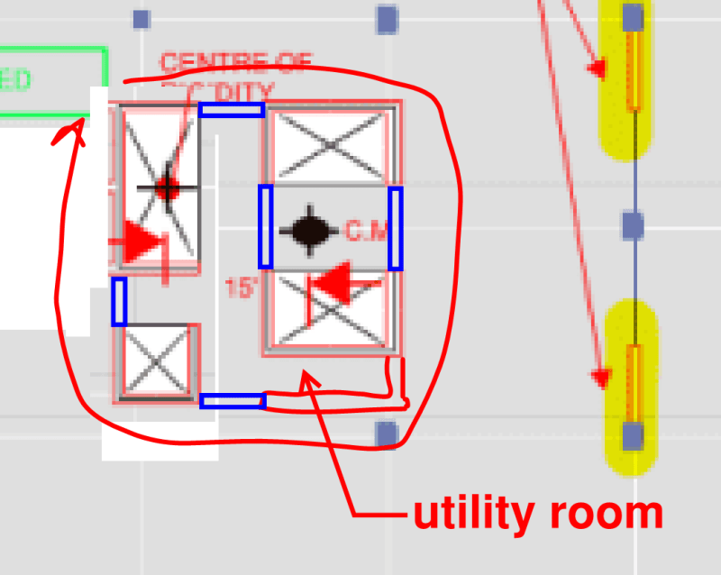

Hi there,
It's going to be a long post but please bear with me. I am currently working on a multi-tower building with a common podium. For high-rise buildings, I am normally assigned the task of creating a finite element model with gravity loads properly applied so as to assist my senior, who takes over the model and carries out the dynamic analysis and from thereon to the design stage too. Meanwhile, I go back to working on other small residential projects.

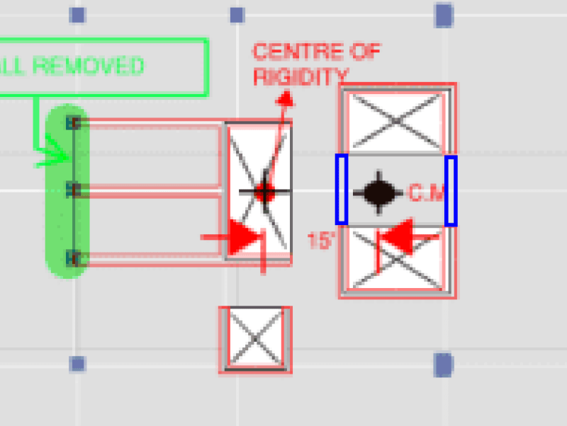

The problem is, my senior is on a leave for two weeks and my boss told me to work on the project and see if the current framing system works in our case. Although we are in an initial phase, my Boss has a meeting with the Architect tomorrow to discuss the basic framing system and layout of shear walls. I am worried that the current layout of shear walls isn't appropriate, given that most of our shear walls are concentrated in one half (left portion) of the tower. I have tried a number of different layouts, which involve adding shear walls to the right of the tower, removing shear walls from the left of the tower as explained in the image attached. Also, I am quite concerned about the impact both the towers will have on a common podium. Both towers have different masses and layouts and I believe both towers, if not have fundamental mode as translational and also in the same direction, will be out of phase which will consequently create very very high demands on the podium level.
Adding to the discussion involving shear walls that have been added on the right to counter inherent torsion, there's no way I can add any shear wall to the right due to architectural constraint.
I haven't previously modeled a multitower building and this is my first one. Initially, I modeled both towers with a common podium. But when I studied the results (modal results), it became quite clear to me that something is very wrong. Therefore I decided to analyze both these towers individually. Upon analysis, it became clear to me that the left tower has a "translational mode" as the fundamental mode, meanwhile, the right tower's fundamental mode is torsional and the time period (5.15 sec)for the right tower is also very high given that tower height above podium is around 280 feet.
I have attached modal results and the basic layout of the right tower only.

To what extent are your wall groups coupled? Coupling will get you some degree of closed section torsional stiffness which might help. I wouldn't sweat the common podium. That's a pretty common scenario and should be resolvable by some means.

Yeah it looks quite soft in torsion with all the walls being concentrated near the middle. Whether it works or not is a complex question.
Why remove those green walls if torsion is a problem?
@Usman - so far it sounds like you have been trying to reduce your torsional demand by trying to move your CR closer to your CM. The other option would be to increase your torsional resistance by generally moving your walls away from your CM. In the X direction specifically, your main walls are very close to the CM. By restoring the green wall as Tomfh mentioned, you will increase your torsional demand somewhat, but you will also increase you torsional resistance.

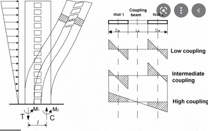

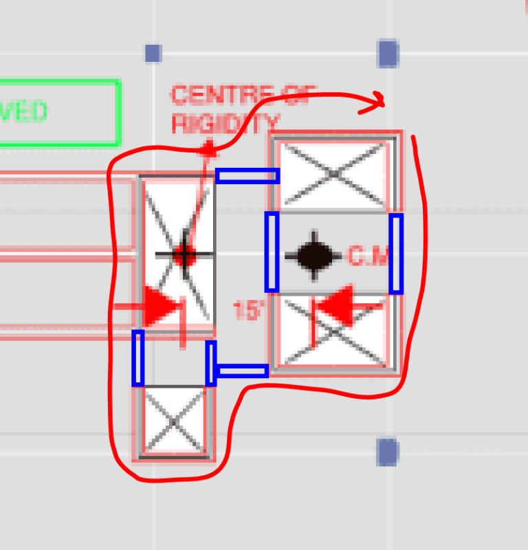

Shear wall coupling is a technique that uses beams to transfer vertical shear between adjacent shear walls and, thus, encourage them to act as composite assemblies rather than individual walls. That has the effect of stiffening the lateral system, particularly in torsion when pseudo-closed shapes can be created. A picture is worth 1000 words. See the picture below.
The coupling beams shown in blue below would seem to be low hanging fruit as they will:
1) Create a pseudo closed box section that will benefit torsional response.
2) Shift the center of rigidity towards the center of mass.
3) Involve conventional construction techniques and require no architectural changes other than local sacrifices of headroom beneath the beams.
Lastly, if you want to knock this out of the park, talk your architect into letting you have an engineer's core. Simple detailing and torsional resistance for days.
@Tomfh I was trying to narrow down the eccentricity between the centre of mass and Centre of Rigidity, as @Chris3eb mentioned in his comment too. It seems like I wasn't looking at the big picture and I am glad that I asked you guys for guidance. Thanks!
@Kootk Thanks a lot for helping me out. I did exactly as you instructed and it resolved my issue completely. With a couple of iterations, 65% mass participation was achieved in the first mode in translation and the almost same figure for the second mode in the other direction. The third mode was in torsion which I suspect won't be an issue. Using the same thought process I tried to optimize the core for left tower and it produced good results too. Demands on moment frames were reduced significantly as a result of the closed system of shear walls with coupling beams.

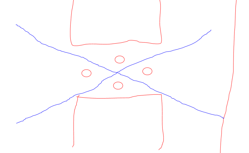

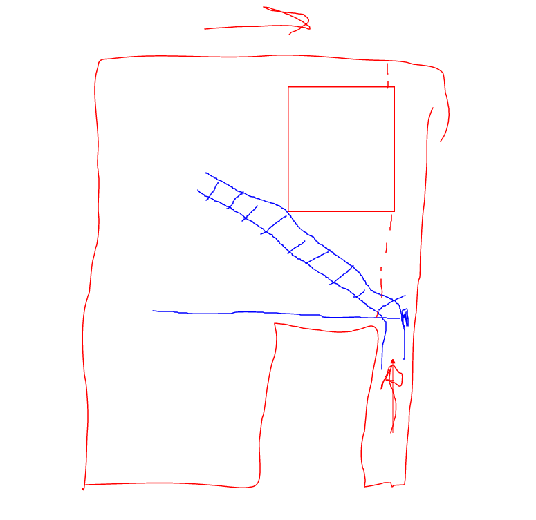

I feel that's resolvable by recognizing that the bars don't actually need to be developed into the right angle walls. It's a different model from the conventional one as the coupling beam is only shear connected to the perpendicular wall, not moment connected to it. The detailing is still a bit tricky, though, and that's what I was referring too earlier when I'd mentioned "ugly detailing". This is actually a pretty common condition for stair shafts where the doors are often placed in the corners of the core. In the sketch below, I've only showed the reinforcing needed for one direction of lateral force. I did that for clarity. In practice, you still wind up with an X-looking arrangement.
