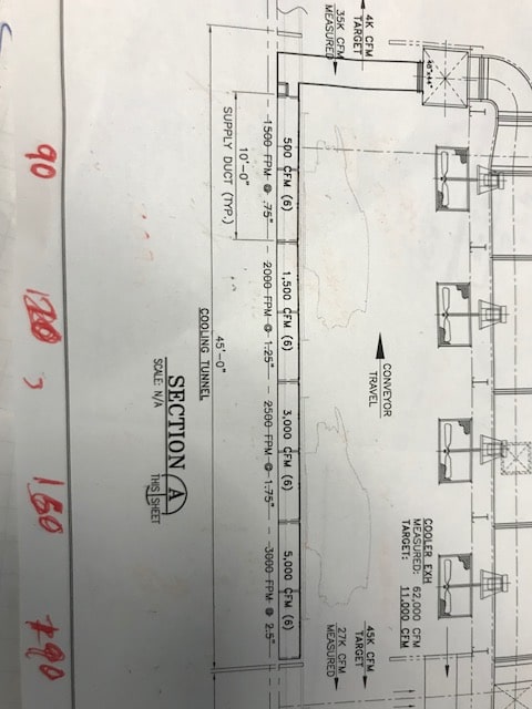

Thanks for the responses. No, it is definitely not a homework question, although I did write it like one. This is a real life scenario at an automotive paint shop. We are trying to cool a car body coming out of an oven. All details are existing conditions except for the air velocity. The plant is asking for projected cool down after our proposed work is completed.

Here is the curve I'm working off of.
[URL unfurl="true"]https://res.cloudinary.com/engineering-com/image/upload/v1525804862/tips/Oven_Curve_r1yh0u.pdf[/url]
Do you know of another formula that would help in this situation. Trying to figure out the maximum temperature a vehicle will be cooled after going to a modified cooling tunnel with new low level duct.
Another question: How would you factor in the 15.24 m/s of air being supplied on the opposite side at the same time?

The thickest part is of the vehicle is the frame work. The hood, doors, fenders tailgate, roof, etc. are thin. The area I am focusing on is the rocker, the area under the door edge the runs front to back. The ductwork we are proposing to install will supply high velocity air toward this section of the vehicle. The specific area and weight of this part of the vehicle is unknown, so I am using the total weight and total surface area of the vehicle to get and estimate of what the cooling will be.
