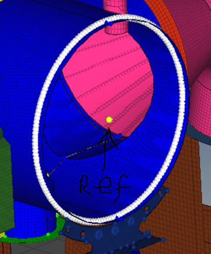

Hi all, I am currently looking into the matter of applying some loads to a large structure consisting of many components.
To make it all simpler I have added a picture to resemble my problem.
I'd like to somehow track the displacement of the pipe center as shown:
It'd be awesome, if I somehow could track this. I don't know if it has to be an average of nodes on the circle.
I have thought about a kinematic coupling could be the solution, but I'm not really interested in imposing any boundary conditions other than tracking what happens at the center of the pipe.
Best regards
Mick

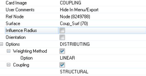

Ok, I can't seem to get Abaqus to even solve this.
What I have done is:
With the following card:
I have tried both with and without the coupling and weighted option enabled.
I am using HyperWorks - do you have any suggestions?
I thought you are using regular Abaqus/CAE environment. But the keywords should be the same. Can you show part of the generated inp file with coupling definition ? Did you try with Uniform weighting method ?

I just created a node in the middle - it's just a reference node. I have not added the DCOUP3D elements anywhere - maybe this is part of the problem?
My surface is consisting of the following:
Where: N_Set_Manifold is consisting of nodes on the circle shown in my previous post - the nodes are associated with S4 elements.
Best regards
Mick
It’s only necessary to define coupling elements when you use the *DISTRIBUTING COUPLING keyword (but this method is not recommended). Change your surface definition to:
*SURFACE, NAME=Coup_Surf, TYPE=NODE
N_Set_Manifold, 1
The last item in the first data line is distributing weight factor.
I thank you, dear Sir.
With regard to the coupling method - I'd guess that when I use shells, that structural is the way to go, as the shells I use have rotational D.O.F's.
With regard to the two coupling methods (structural and continuum) - it seems that continuum is default. I use shells and have therefore rotational D.O.F's, so I guess I should use the structural coupling method? Or is this addition of coupling method necessary? :)
Indeed the default type of distributing coupling is continuum. And it’s also true that for shells it’s better to use structural type.
If you're using Hypermesh, the easiest way to create a distributing coupling element is:
1D > rbe3
dependent > calculate node (will determine the approximate area centroid)
independent > select your nodes
dependent dofs > keep all selected (unless you don't want one of the DOF coupled)
weight > 1 is good for what you're doing
elem types > coup_dis
I would not use structural coupling unless you have a very specific need for it (usually colinear nodes on the end of a shell where you want to transfer the bending moment). Using the rotational DOF of the independent nodes can cause issues. Continuum is the way to go. It will still calculate average rotations at the dependent node, it will just be based on the average "swirl" of the independent nodes.

I got the solver to converge with the surface consisting of nodes and the yellow reference node in the middle.
Would you suggest using the distributing coupling element with 1D -> RBE3 method instead, and if so - why?
Or are both methods for tracking and obtaining the centroid coordinates similar?
No, that menu just automates the creation of the distributed coupling element. Creating it through the model tree is also acceptable, just takes a bit more input. The only suggestion I would give is to avoid structural coupling.
