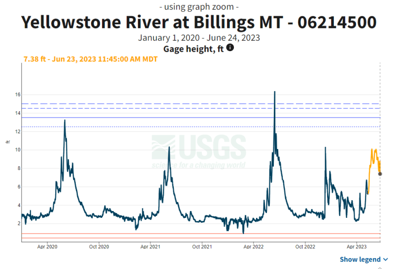

Train derailment or bridge collapse? Which came first? The AP report says the bridge collapsed, causing derailment. But how does their reporter come to that conclusion?
There appears to be a pier missing. There's a nice looking one over on the right. But I don't see nuthin' over on the left, between the two truss spans.
The high water level has me thinking the pier washed out.

Railroads have a system to detect a broken rail. Maybe partial washout and bridge stayed intact until the train crossed.

Maybe. But piers are usually VERY sturdy. And a train derailing, and kicking a truss span out, will usually not knock a pier down.

Looking at those Street View pictures the pier looks to be quite damaged on the upstream side.
Looks more like a pier collapse to me.
Now maybe it moved enough to cause the derailment which then caused more damage but the bridge would be my first thing to look at.
