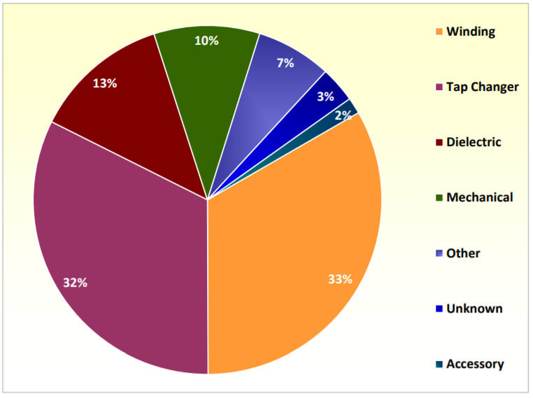

Perhaps some of the reasons not to use LTC are: reliability, maintenability, and cost.
Source: AC Substation Equipment Failure Report, NERC ACSETF
One utility I worked at had LTCs but never used them because they had problems with them always tapping while fighting each other. It was probably more an issue of somebody not setting the controls properly than the LTCs themselves. They just went with a winter and summer fixed tap and switched in and took out cap banks to regulate the voltage.

The global trend of transformer failures is 1/3 in windings +others 1/3 in OLTC and 1/3 in bushings. In Europe OLTC failures are more than bushing failures. In India bushing failures are much more than OLTC failures.
