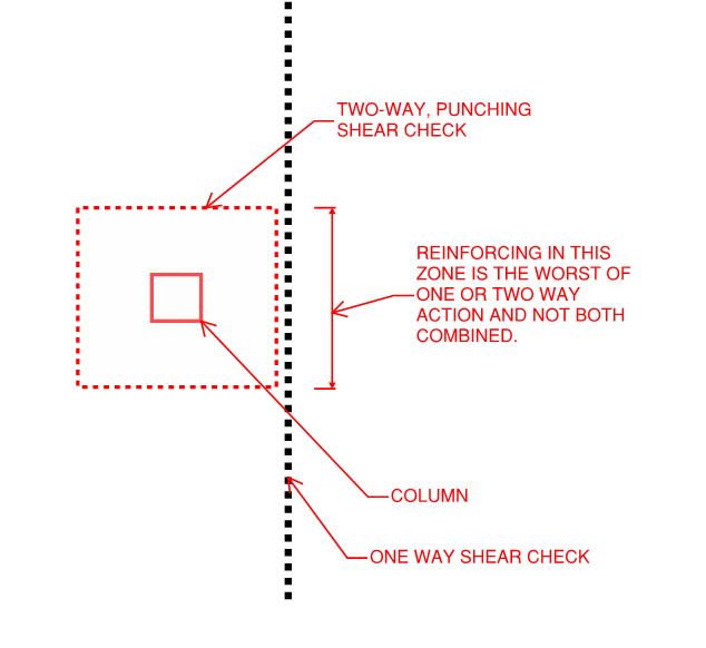

In my opinion, one and two way shear reinforcing demand are not additive where they would overlap.

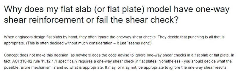

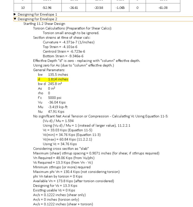

Funny enough I'm working on a transfer slab now and just ran into the same issue here are some screen clip to illustrate what I mean.

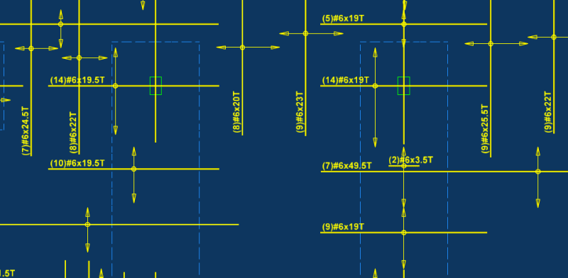

Program designed top steel:

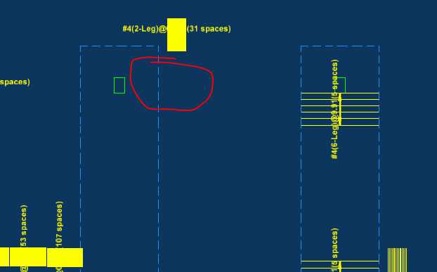

Program required shear reinf.:

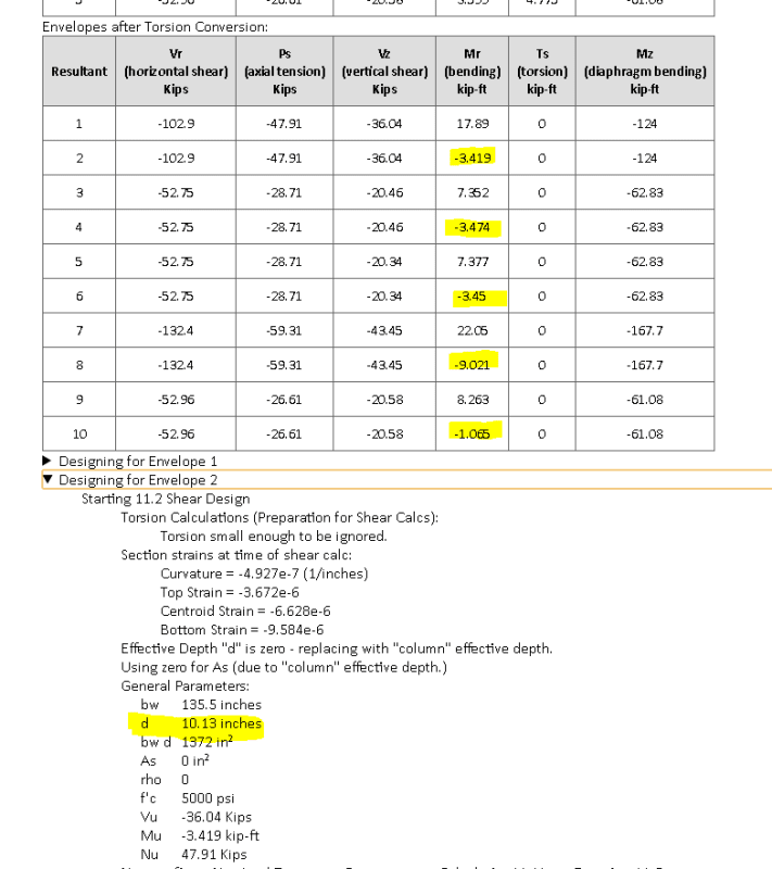

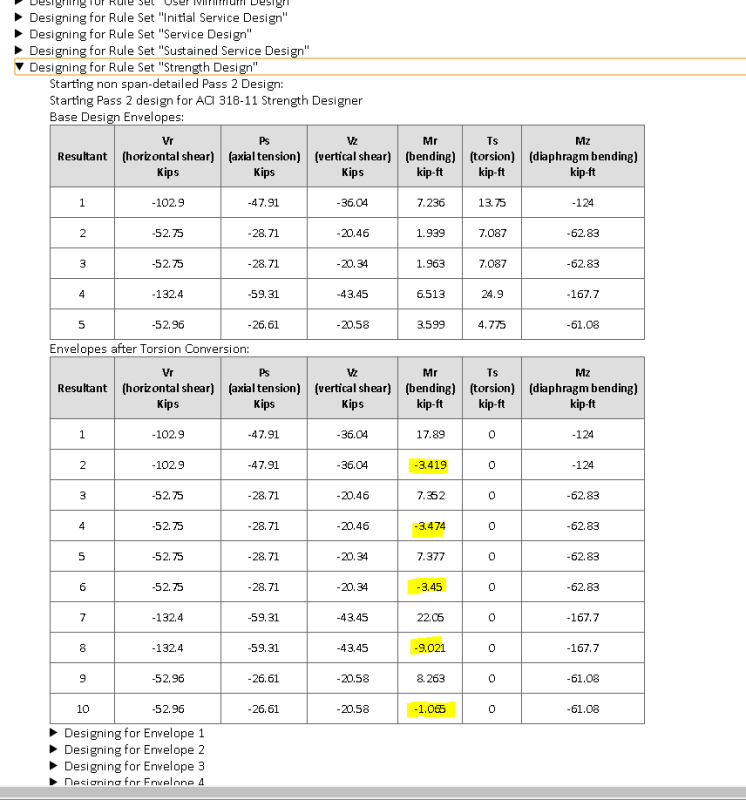

Audit of the cross section, note Wood-Armer causes moment reversal in some design envelopes and as detailed the top steel does not get into this section so "d" is taken from the bottom mat to the compression face, 1.8+/-": Edit: Actual if you read the audit you'll note it says effective depth is 0 so switches to using column effective depth.

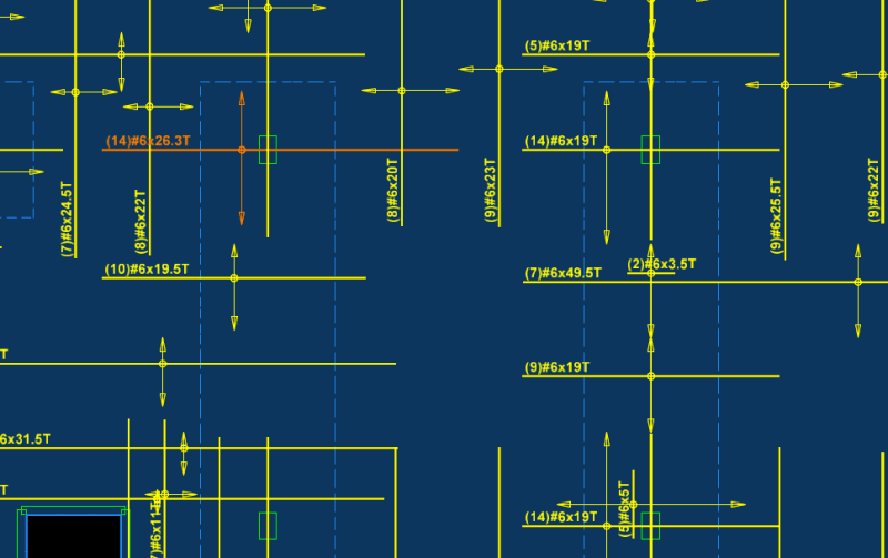

Making the top bar a user bar and extending the length, need to document this in the contract doc since it won't follow standard detailing rules now:
The Shear bars go away:
and the cross section audit still have the moment reversal but now the top bar is long enough to be in the design section and d is now 10.13":
A software vendor has little choice but to handle the issue below with kid gloves on. Luckily, I'm not similarly constrained.
Folks who ignore a failing one way shear check need to revisit mechanics of materials 101. Although we often treat shear capacity and bending capacity separately, they are in fact very much coupled. If you don't have your one way shear capacity, you also don't have your designed bending capacity. And all the punching shear capacity in the world doesn't fix that. The only reason to ever not check one way shear is because you're highly confident that it won't govern, not because you think that it doesn't matter.
BTSG said:
When engineers design flat slabs by hand, they often ignore the one-way shear checks.
