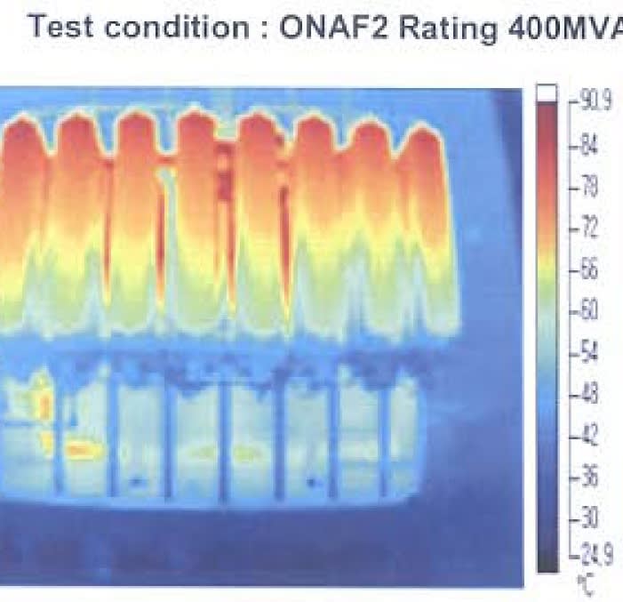

One way manufacturers deal with leakage flux is by attaching layers of core steel type material to the tank wall. During a heat run test, the extent of the sheilding is quite evident as seen in the attached thermal image. The sheilding begins about 0.6 meters in from the sides and bottom of the transformer. At the bottom left corner without shielding, the tank wall was about 15 C hotter that areas without stray flux.
