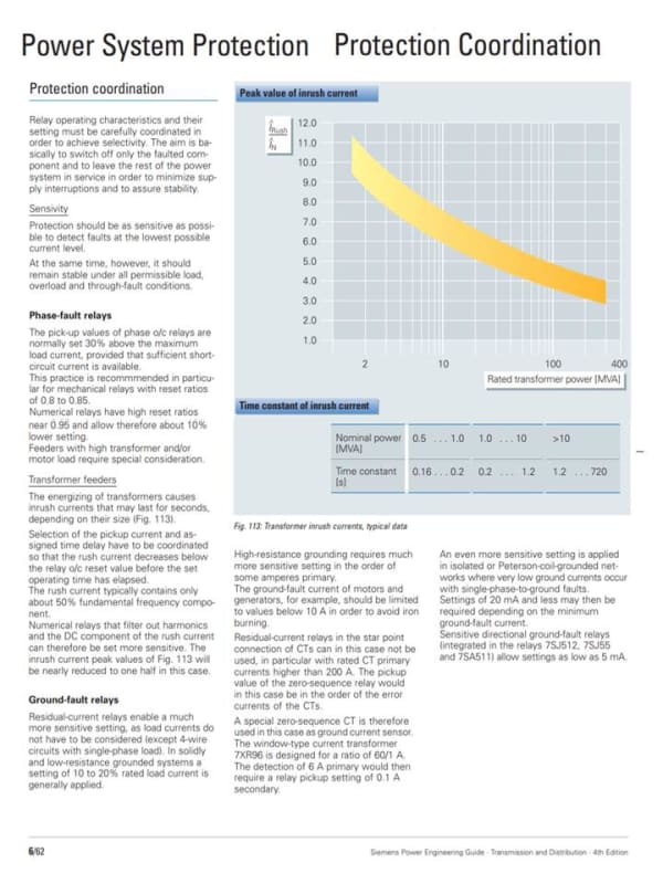

Below is a graph showing the estimated Inrush range vs. transformer MVA rating. The graph indicates that the Inrush current decrease as the transformer MVA increases. The inrush current values in the graph are lower than the numbers typically used for coordination.

This graph looks reasonable for oil-filled transformers. Certainly too low for larger dry-type transformers. I've proven that in the real world. But the downside of nuisance tripping outweighs that marginal increase in protection by trying to get as close to the maximum inrush current as possible, IMO.
