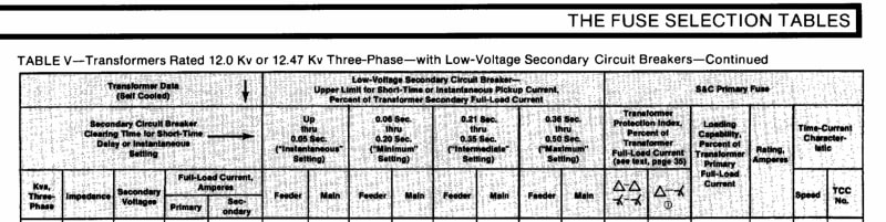

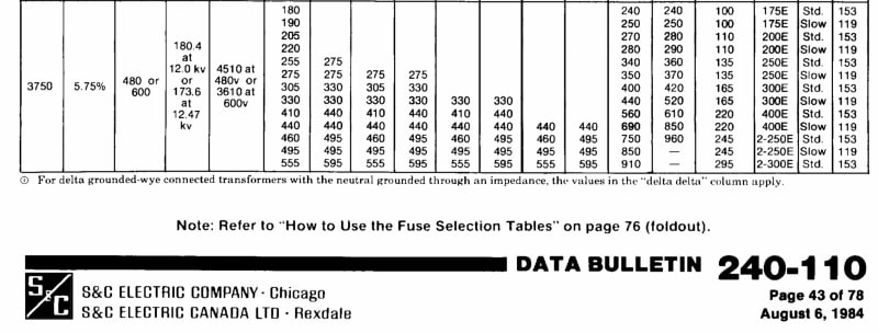

Below is an excerpt from S&C Table for E-fuse selection. Notice that optimal protection should consider the Transformer Protection Index and the Loading capability.
a) The Transformer Protection Index is associated with the total clearing of the TCC curve selecting the primary E-fuse to pass below and to the ANSI Point of the appropriate transformer short-time characteristic curve, and second, the point at which the two curves intersect should be at as low a multiple of the transformer primary full-load current as possible.
b)Loading capability refers to the amount of load the transformer-primary fuse can pick up (even after a momentary loss of source voltage) without operating, and carry on a continuous basis. The values listed in the fuse selection tables were determined to be the minimum of continuous peak-load, hot-load,and cold-load pickup capabilities for each fuse ampere rating.
