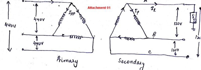

Good Day,
My question is in regards to connecting an unbalanced load, single phase, 120VAC (10 fans) to a delta-delta transformer. Load is 8.3A rated current at 120VAC. Once we connect these 10 fans to the transformer we have phases B and C broken. Why is it that there will be a virtual and a real transformer? Which phases are the virtual, is it the one to which we connect the load, or is the ones that are broken? Now, if our pf = 1 (purely resistive load) and we have a 10kW load, the A phase supplying power to the load will split into 5KW and 5KVA. Why does it split? Where does the 5KVA comes from? Similarly, the other two phases (B and C) provide 5KVA each. I’m confused about why that occurs. Could someone clearly explain this topic with diagrams and point to a text where it explains this notion. Please help explain/visualize this. Also, if we have a center-tapped delta-delta transformer and we tie 10 fans between two phases and neutral, would we also have this virtual transformer issue?
Experts, could someone answer my question. I would very appreciate it.
The question makes no sense. What do you mean “broken” and “virtual”? How do you expect fans to have a PF of 1?
davidbeach,
First of all, I used pf = 1 as an example. Let's say that our three phase delta-delta transformer has Phases B and C unloaded and only phase A is connected to the 10 fans. That way, we connect the 120VAC, single phase fans between Line A and ground while the other two phases are open or broken. I am referring to an example from a thread I found on this forum (link below), the only drawback is I do not understand waross's explanation. In that thread, he also used the term 'virtual transformer' and I took it from him. If someone can actually explain in simple English what is meant by his answer I would appreciate it.

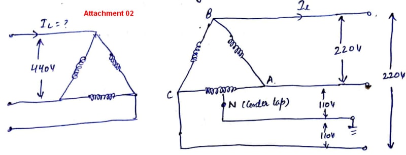

Another question I have is whether this virtual transformer and real transformer power splitting phenomena occur when we have a three phase delta-delta bank, center tapped, providing 120VAC single phase and 240VAC three phase on the secondary?
No don't remove a transformer.
The three phase delta, three transformer bank stays as it is. The example of the virtual transformer and the real transformers is to explain the loading. When you put the real transformer in parallel with the virtual transformer, you have the original three transformer delta bank.
Yes but the splitting is more complicated with 120 Volt loads.
Now part of the load is supplied directly by the 120 Volt winding. The transformer/phase that the load is connected to is still supported by the other two phases, but now the in phase transformer is also acting as an autotransformer.
I am not sure of the exact load splitting. I have never had occasion to work it out.

Now I'm a little confused again. In your earlier post you wrote: 'An open delta connection in North America develops three phase power with only two transformers. The two real transformers together form a virtual transformer in place of the missing third transformer.' I have been reading this text (excerpt below) about open delta. Could you confirm if what we both are talking about is part of the same concept. In the text they refer to open delta as a condition when one of the transformers, let's say ba, is missing or has been removed from the three phase transformer bank. Please explain what should be understood by this statement as well: 'However, for the purpose of single phase loading on a delta transformer bank it sometimes helps to consider a single phase transformer in parallel with the virtual transformer formed by the open delta.' Does this mean we have two transformers and we could connect single phase load in between either phase and ground; however, for calculation purposes of loading we need to imagine we have a virtual transformer (our phases ab and ca from text below) and a real transformer in parallel with each other? In other words, in one situation the schematic would look like attachment 01 and in another case it could look like attachment 02. What are the differences and similarities going back to this virtual and real transformer concept? Please lead me in the right direction.

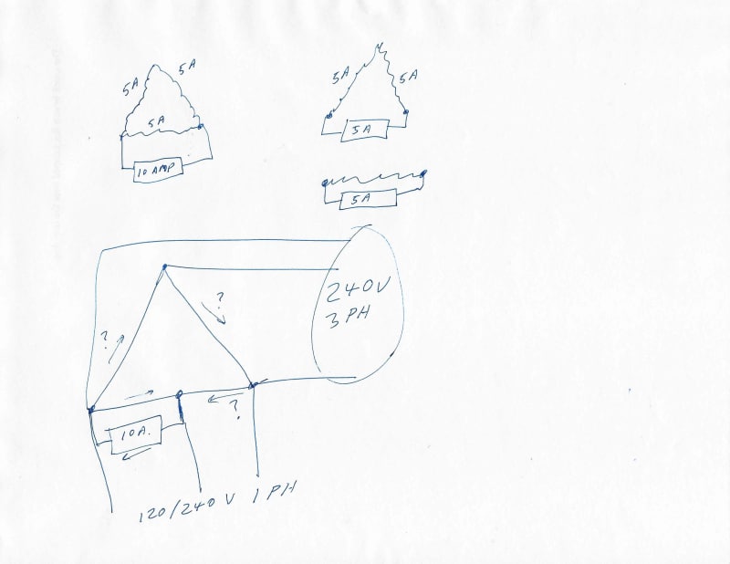

This shows a 10 Amp load on a delta transformer. Next shows how the load splits between the in phase winding and the out of phase windings.

waross,
So, your four wire (A, B, C + Neutral) delta connection will also exhibit the virtual transformer and real transformer concept? For any single phase load we connect to a delta transformer we will always have this occurrence as long as the load is unbalanced? In other words, what are the requirements for a delta connected load and configuration (4-wire or 3-wire) in order for this concept to be true?
Yes. Concept is the important word.
When one transformer is removed fro a three transformer bank, a virtual transformer is formed in its place. That virtual transformer has similar %impedance(single phase), and voltage regulation as the transformer that it is replacing.
The virtual transformer may be considered as a single phase transformer in parallel with the appropriate phase transformer to explain load sharing and the increase in transformer KVA losses.
