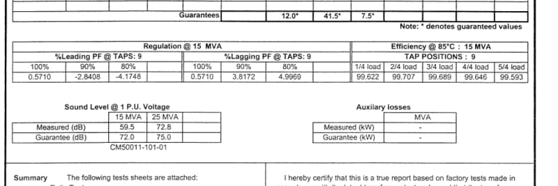

Thanks Waross. As I understand, power factor plays a significant role- a leading power factor may even raise voltage.

I have tests reports showing regulation for various transformers, but unsure how to mathematically obtain these results when impedance and X/R is known.

Mbrook, J&P 12 th edition Please refer Section 1.6 under Transformer Theory.
% Regulation is always reported at 75C and change with temperature is negligible with temperature change, at least for medium and large transformers. This is because % R (Vr) is always very low (0.5 %-0.1% 20-1500 MVA ) compared to Vx (>8%)
% Regulation at unity power factor = Copper loss kWx100/ Rating in KVA + square of (percentage reactance)/200 ( the second term is prominent in this case)
% Regulation at any other power factor(angle phi) and part load ( 'a' pu of rated load) = a(Vr cos phi + Vx sin phi) + square of {a ( Vx cos phi-Vr cos phi )}/200.
Vr % = Copper loss (load loss ) kW x100 / Rating in KVA
Vx = Square root of ( square of percentage impedance -square of Vr)
