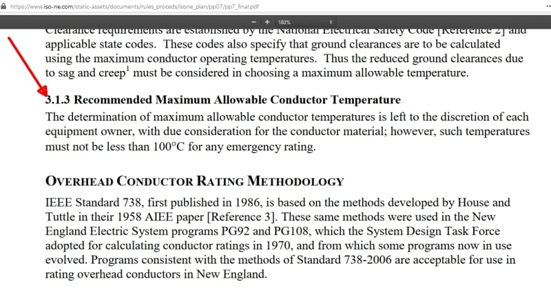

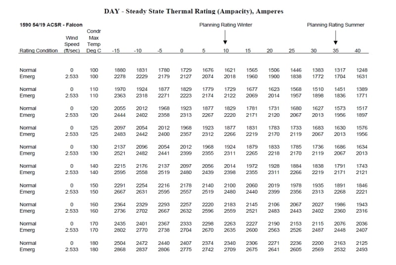

From PJM's line rating guide, listing going over 100*C on ACSR:
Typically North American ISOs want emergency ratings to be no less than 100*C:

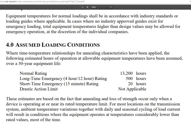

On the idea that LTE and STE ratings will be limited in duration and frequency relative to the in service life of the equipment:
Thus temps above 100*C can occasionally be encountered in reality and must be taken into account. At least that is what contingency load flows that I'm crunching are telling me.
Many utilities use temperature over 100C for emergency ratings. It is very rare to actually operate the line at over 100C. I have seen various utility rules for time limits, but I have never figured out how they actually track lifetime exposure to each temperature.

it is quite strange, to me, to refer to a 30 years operating lifetime: generally a 50 years lifetime is considered here for ACSR conductors (obviously excluding zones close to the sea); we have severeal thousands km of ACSR conductors installed in the '50s or even before.
