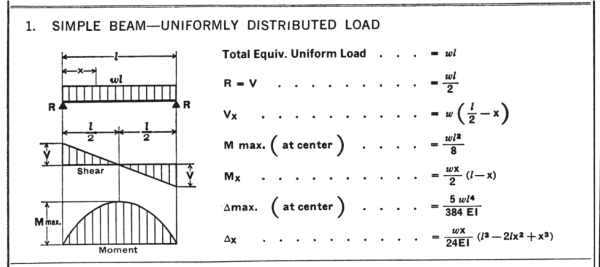

Looking for a little input on a temporary shoring design. They went ahead and built the system they want to use, but didn't do any calcs to back it up. What's the best approach for checking the stresses in the aluminum members? For what it is, I'm sure there is enough capacity, but just need a calc to support it.
I'd want a laboratory supervised load test and report signed by a PE to show the failure loads that can be applied to the struts with pinned connections. Same goes for the horizontal members. Struts should be pre-bent say 1/20th of span. As to what loads to take for design, I'd apply a significant safety factor to straight un-bent to allow for unexpected job loadings such as equipment and personnel weights on the struts and some actual bending of them. Bent test result should not be exceeded by working loads. The wood sheeting on the job might be significantly different than what the model has. A summary report might cover the minimum wood sheeting strengths recommended, but suggest limits as to depths of use assuming soil density of 1.0 times on-site typical densities, fully saturated. Any local codes also should be shown as covered by the set-up proposed.
Would it be possible to model the frame using a 3D structural program? All of the aluminum members are 3”x3”x0.25” I attached a sketch looking down from the top.
To get the bending moment, check the longest member (60") as a simply supported beam with a uniformly distributed load. Then calculate maximum bending stress. The beam will probably be fine for most practical loads, it's span (60") to depth (3") ratio = 20:1 is reasonable.
The hard part is determine the uniform distributed load applied to the beam. You will need to know both soil properties and how the shoring is used. At best the applied load will be a SWAG.
Also, check the to see if stress in the lumber is acceptable.
IMHO, put the software aside, all it will do is give precise answers to a question that is inherently approximate.
