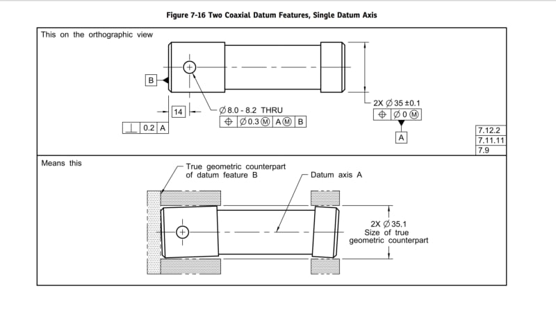

Hi
Please find attached sketch ,
The sketch is simply to illustrate a 2x cylindrical shaft diameter as a common datum.
My question , as most of you guys are aware my experience with true geometric counterparts is limited. ( due to most of my inspection experience is on a CMM )
As this is a 2x will the geometric counter part be like a bush that would touch an mate against the most outer points of the two cylinders ?
I have done the sketch to show a potential issue where by machining flaws or another reason the front shaft diameter is slightly tapered to the other one.
I am trying to understand if this scenario happened or the front cylinder axis was just 0.04 off center , how does this affect the geometric counter part to derive a common axis between the two cylinders .

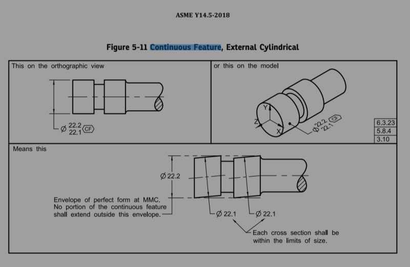

2X and CF are same meaning? i.e, to be treated as single feature?
2X in conjunction with position within zero at MMC, datumless, applied on two coaxial cylinders with the same size dimension and tolerance, is equivalent to CF.

I think below image from ASME Y14.5:2018 may be referred.
Burunduk
How to inspect the part?
With single cylinder of dia 22.2 or two cylinder of dia 22.2 placed coaxially?
Sa-Ro,
As you can see in the means this portion of the figure you posted both cylinders are evaluated to a single 22.2 envelope of perfect form at MMC. When inspecting the requirement, a single gage should be used unless perhaps there is some technical difficulty. Using 2 coaxial gage cylinders will introduce some measurement error, because of coaxiality inaccuracy.

The figure you showed from the standard , Datum axis A is derived from the simulator.
As I have previously stated my CMM software I am creating constructed axis between the two cylinders to create a common axis. I am not convinced the software is accurately creating the true Datum Axis A as it would if I were to use a true geometric counter part.
So if you have a geometric counter placed against any highest points of the two coaxial cylinders . The axis of this geomteric counter would be the datum ?
Again referring to your post with the drawing from the standard. The means this portion .
Both datum feature cylinders Axis are completely off to the middle cylinder axis
Though using the geometric counter part and using this axis, it looks completely coaxial to the middle cylinder. This confuses me I must admit .
Any help on this would be greatly appreciated
Yes. The datum axis is always the axis of the "true geometric counterpart" or as I am more used to call it because I'm working with the 2009 version of the standard - "datum feature simulator". If the datum reference is regardless material boundary (no modifier near the datum letter in the feature control frame) there is coincidence between the axis of the datum feature simulator and either the axis of the unrelated actual mating envelope of the feature (for a primary datum feature) or the axis of the related actual mating envelope (for secondary or tertiary). In your case, the datum feature is a pattern referenced at maximum material boundary - in this case (because of RMB), the datum axis may not be congruent at all with the axis of the related or unrelated actual mating envelope, because there is shift allowed between the datum feature and the datum feature simulator from which the datum axis is derived.
I truly don't know how much all this can help you with the CMM.
Are you also producing the parts or just measuring them?
If there is an option to potentially reject some good parts in favor of easier inspection with CMM, consider treating it as a datum feature referenced RMB.
In your case, the datum feature is referenced regardless material boundary (RMB).
RMB is a more stringent requirement than MMB (like RFS is more stringent than MMC) so you are not expected to approve any bad parts. For RMB you would have to simply use the high points on both cylinders to simulate two coaxial mating envelopes that contact those high points on both cylinders without one cylinder getting any priority (tighter connection with the simulator) than the other.

RWelch9,
Here are a few thoughts.
Your drawing specifies 2X and a position tolerance on the OD's. This means that:
-The two OD's are treated as two distinct features.
-When labeled as a datum feature, this creates a multiple datum feature (2009) or a common datum feature (2018).
-For the RMB datum feature reference, there would be two cylindrical simulators/TGC's that are fixed in location relative to one another (i.e. coaxial in this case).
-In 2009, "The datum feature simulators shall expand or contract simultaneously from their MMB to their LMB until the datum feature simulators make maximum possible contact with the extremities of the datum feature(s)."
-In 2018, "The true geometric counterparts shall expand or contract simultaneously from their worst-case material boundary to their LMB until the true geometric counterparts make maximum possible contact with the extremities of the datum feature(s). When irregularities on the feature(s) may allow the part to be unstable, a single solution shall be defined to constrain the part."
If the drawing had specified <CF> instead, then it would mean:
-The two OD's would be treated as one "continuous" feature.
-For the RMB datum feature reference, there would be one cylindrical simulator/TGC.
-The simulator/TGC is the smallest circumscribed perfect cylinder that makes maximum possible contact with the datum feature surface
The two OD's in your drawing have the same nominal size and size tolerance. This avoids additional cans of worms that we would have to open if they did not.

Sorry I am slightly confused, So 100% this would be two separate TGC.
My question regardless of if i use physical counterparts or virtual on the CMM.
At what point of the the two cylinder axis to you create the common datum.
