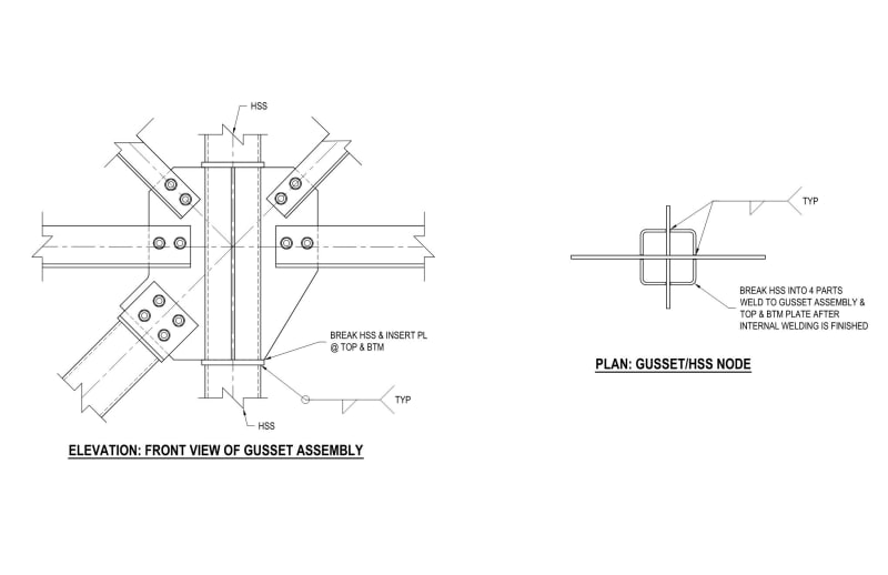

Could you extend the HSS column up to the top elevation and create a gusset plate "node" at the location where the bracing members come together? Something like this, where the HSS is broken, the gusset is welded, then the HSS quarters are re-attached:

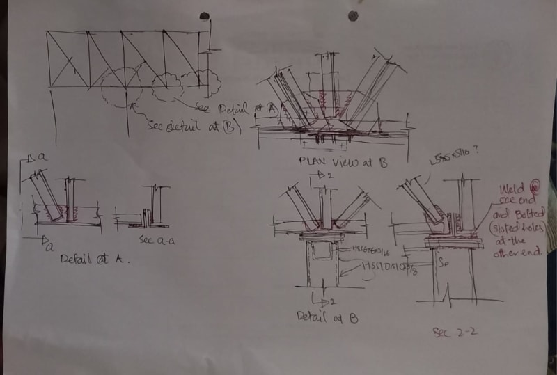

I had something on my mind, shown in the sketch below,

I really appreciated your effort, but I would not want to break the contiuity of the Truss core because of my own interpretation and planning of how these members could be arranged refer to the sketch below
