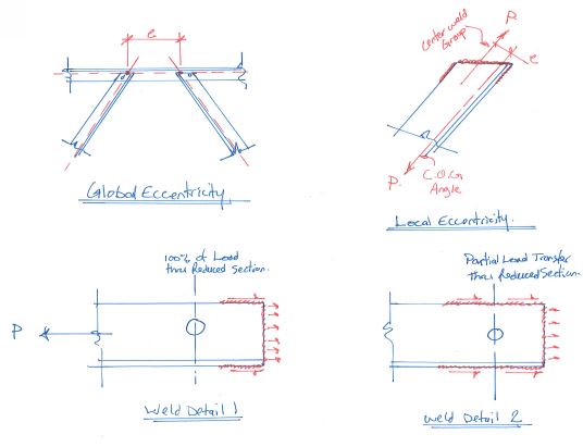

CANPRO - Regarding the Internal Bracing diagonal cracks and fracture, I did not fully understand what you were trying to convey. Could you please explain it a little more. And, yes, the third leg of the weld is indeed longer and could be a source of eccentricity like you mentioned. Also, the current details that I have seen in recent projects does have gusset plates to connect these angles but seems like the existing detail was the norm back in the day.

ELNW: Your comment about weld length and eccentricity is correct, you likely have some local eccentricity in the connection. There also appears to be quite a bit of global eccentricity. See sketch below.
I've tried to clarify my comment with the load transfer through the bolt with a sketch. It appears that in your case, 100% of the brace load passes through the reduced section of the angle. If there were more weld length that extended beyond the bolt, you'd have less load going through the reduced section.
