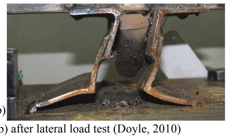

Dialing it back to the decision to use joist rollover or not, for many fastening schemes I would consider joist rollover to be ductile. More ductile than most things really.
Yes, the aggregate system strength, although I believe that there used to be precedent in the code for using phi=1.0 with amplified seismic load combinations even when checking individual elements. Unfortunately I can't recall where I've seen it.
Philosophically, I don't have as much of an issue being liberal with the strength reduction factor (which I have done myself on occasion) as I do with neglecting to consider the overstrength factor altogether. The effect you described above wouldn't be enough to make up for a 300% shortfall in demand--possibly more depending on the SFRS and how it was proportioned by the designer--unless the demand capacity ratio was kept low to begin with, in which case one could argue that the system already was designed considering amplified loads.
I wish I could offer an informed opinion on available ductility of joist rollover, but where I practice it's routine to use collectors / blocking between the joists.
I'm sure that your opinion would be as informed as anybody's. Even for those of use who utilize joist rollover it basically comes down to one's judgment regarding the situation shown below: metal plates forming plastic hinges with no real propensity for local buckling.

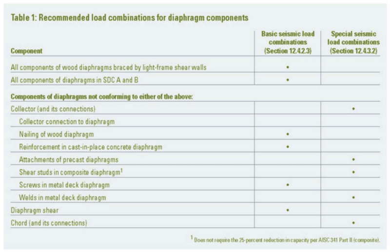

Great picture KootK, thank you. When relying on rollover, do EORs typically specify whether the joist seat will be stiffened or unstiffened? I imagine that would impact the decision on whether it can be considered ductile.
sticksandtriangles said:
I would not "omega"fy the HSS tube collector design, but I would record omegafied loading to the joist girder top chord and then any connection of the joist girder top chord to the lateral force resisting element.
Not that I agree or disagree, but what is your rationale behind not amplifying the load? Is it the the distributed strength argument? Granted, it's probably a moot point for this particular condition given that the amplified diaphragm demand is trivial compared to the shear transfer capacity of a tube collector with nominal welding.
For those that subscribe to the unamplified demand / distributed strength argument, do you also disagree with the article I posted above that shear studs in a composite deck should designed for overstrength when delivering diaphragm shear to collectors?
Unfortunately I do not have great rationale for why, I deem the joist girder to be the start of my "collector element" per 12.10.2.1 and design accordingly. Anything above that, being the HSS tubes and deck attachments gets the load to my collector element.
I have not designed shear studs in composite deck for overstrength either... not sure if that is correct. I also do not design chords and their connections for overstrength (last bullet of your table Deker), I only design collectors and their connections for overstrength.
I don't specify it but, at the same time, I have every expectation that it will either work unstiffened or we'll be doing something else (lugs etc). The cost differential between stiffened and unstiffened joist seats can be shocking in my experience. This is third hand information at this point but a very knowledgeable person here suggested to me once that the cost is less about the addition of the stiffeners themselves and more about messing up the ability to nest joists together for efficient shipping.

Much depends on the situation. OP's situation is CMU shear walls by the sound of it. In my neck of the woods, that would mean that the tube lugs would get welded to small embeds in the CMU which would then become the brittle link in the chain and affect this calculus:
1) If I can make a go of it with joist rollover, I need to do that to stay competitive.
2) If I can make a go of it with a tube lug every other joist space, I need to do that to stay competitive.
I wouldn't say that I disagree with it, per se but, rather, that it's a bit of a surprise to me and it moves the conservatism needle a bit further over than I usually put it. Some thoughts:
3) I noticed that concrete to concrete shear friction is in the ductile category. That surprised me a bit. I've no doubt that grinding the interface down to a fine powder and then picking up some truss action probably does give you a decent hysteris loop, at least for a few cycles. But then, in a way , it still kind of is a version of unreinforced concrete shear.
4) In many ways, I see well distributed composite studs as being just another version of shear friction, albeit a lesser version between dissimilar materials. Moreover, the very procedure that we use to calculate the flexural strength of composite beams assumes some ductility in the connections between the studs and the slabs. So, in these respects, yes, I was surprised to see composite studs on the list.
5) In many ways, I see well distributed composite studs as being just another version of shear friction, albeit a lesser version between dissimilar materials. Moreover, the very procedure that we use to calculate the flexural strength of composite beams assumes some ductility in the connections between the studs and the slabs. So, in these respects, yes, I was surprised to see composite studs on the list.
6) Obviously my general argument about distributed connections would apply to this as well.
7) The article mentioned that the authors and some of their external associates were using this, more conservative approach despite it not really being codified. I have mixed feeling about that:
a) One the one hand, I celebrate a group going above and beyond what is codified based on their judgment. The rare, "race to the top" as it were.
b) I feel that it harms are profession a bit when you get stuff like this floating around that suggests that what many engineers are doing is incorrect / less correct without that stuff having made it into codes and/or widely accepted design guides yet. In sending out mixed messages to the design and construction community, we undermine ourselves I feel. Collectively, we seem wishy washy in a way that diminishes confidence in what we do. If it were up to me, we'd keep this kind of stuff close to our chests until a consensus is reached and disseminated. That said, I doubt that many contractors are reading Sabelli articles or identifying there reasons for relatively slight differences in connection strategies on EOR drawings.

Alright, sign me up for TEAM OVER STRENGTH then. I'm substantially convinced.
Taking the drill down a bit further, another place that I see inconsistency is in the calculation procedures normally used to determine the demand in distributed diaphragm connections. Designers will normally make the shear panel assumption and assign all of the diaphragm flexural demand to discrete chords. In reality, you almost always have distributed chords which could amplify the peak shear connection demand by 50%. This, in reference again to the potential unzipping of brittle things.
So, tallying some of this stuff:
1) You've got a real world overstrength factor that might be as much as double the ASCE values.
2) You've got DCR ratio problems only loosely accounted for.
3) You've got diaphragm forces different, and higher than, VLFRS forces in multistory structures.
4) The procedures for calculating distributed shear connection demand are gross approximations.
5) There will be a significant redundancy benefit even if it's difficult to pin down and likely less than 600%.
6) In my experience, many common diaphragm to VLFRS connections are non-ductile. Certainly that is the case with CMU.
