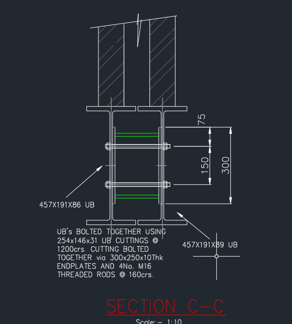

Hi all-
I have a twin beam scenario supporting blockwork and brickwork above.
A typical detail is to connect these twin beams with UC offcuts, welded to one beam and bolted to the other.
If these are spacaed at say 1m cc. does that reduce the effective length to 1m?
or will they assit with load share
or both?
I have had a user friendly document in the past covering this but i cant find it again.
discssion will be appreciated

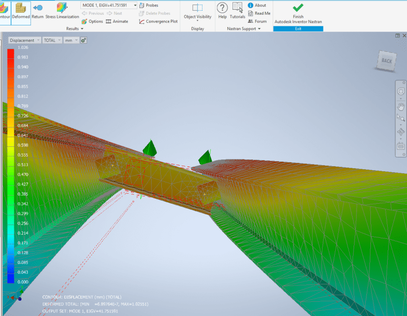

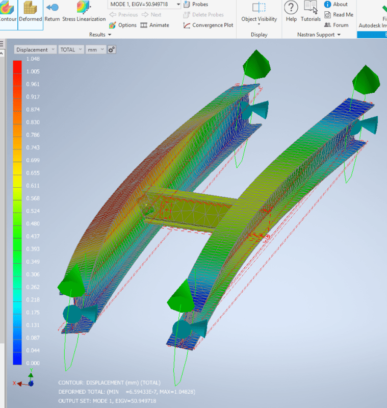

Here is one side with a perfect pin.
We now get 50.9kNm. We have reduced the effective length from 6m to 4.4m!
human909 said:
The two bolt connection (not a single bolt) is pretty stiff for what is needed. Its a long way from a moment connection but it is also a long way from a pivot.
I assume you are talking about two bolts at one end, not one bolt on each end, which was my thought and drawn on my response to KootK above. The brace effect might be there when the flange of the brace against the web of the beam, this is not desirable though. But now I can see why KootK says the added end plate helps, if it is welded to the brace, then the brace itself is quite stiff, because geometry deformation is not likely to be significant for such short member length.
On the other thread, the connection in concern was tying floor beam to girder, thus it is reasonable to think the connections had at least two bolts on each end, and the floor beam is at lease 1/3 to 1/2 of the girder depth, therefore it can be seen as a sturdy braced point. In addition, by eye ball the floor layout, the floor beams were quite closely spaced, thus, the girder is considered fully braced by judgement call.

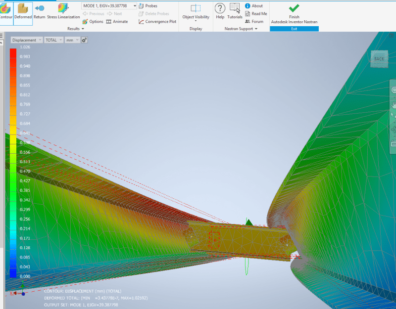

And at first you think that two perfect pins would give ZERO restraint to buckling. This would be true if the pin was perfectly central to the web of the beam. However any normal attachment would likely have some horizontal eccentricity to the web centre. This restrains the beams slightly as in the lowest buckling modes the distance between these points change. With two pinned connections this cannot happen so the buckling occurs at moderately higher loads.
39.8kNm (5.2m effective length reduced from 6m)
41.75kNm (5.05 effective length)
Just gained from moving from 30mm eccentricity to 50mm eccentricity.
** Disclaimer. These buckling moments are not the capacity of the members. This value is used to calculate your slenderness reduction factor for your beam.
Don't sound the alarm. Also 1.04626mm max. deflection? Can you provide beam size and length?
This is linear (eigenvalue) buckling analysis. I'm only putting a nominal 1kNm on each end and then running the model to reach the buckling modes. The displacement is meaningless. (I could probably do a non linear buckling analysis with the result of the linear analysis but this is a fair bit of work.)

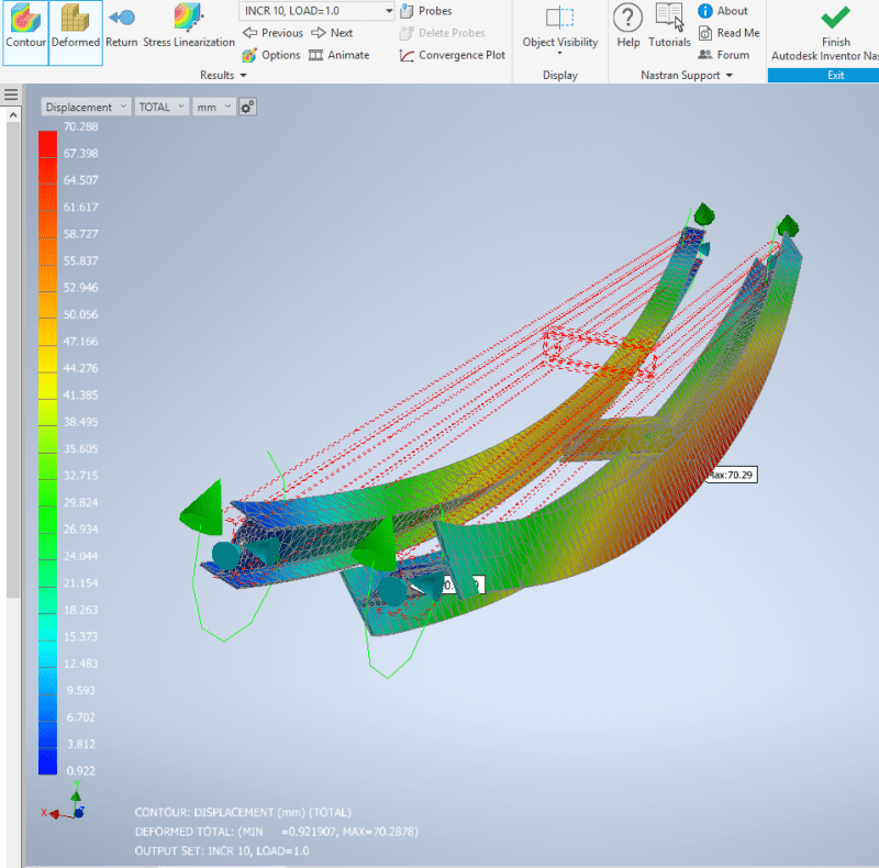

OK I ran the non linear analysis of the same beam displayed earlier. (2 pins in restraint, buckled 41.75kN) I put 50kN into it in 5kN increments.
25kN: 23.5mm max deflection (0.94mm/kNm)
30kN: 28.3mm max deflection (0.94mm/kNm)
35kN: 33.1mm max deflection (0.94mm/kNm)
40kN: 38.4mm max deflection (0.96mm/kNm) twisting barely perceptible
45kN: 44.6mm max deflection (0.99mm/kNm) slight twisting
50kN: 70.3mm max deflection (1.41mm/kNm) significant buckling twist
As you can at 40kN and 45kN the max deflection has increased slightly indicating that it is starting to buckle. At 50kN the beam has well and truly buckled
(Deflection NOT to scale)
Note this too 15mins just to process the analysis, most of that time was spent on convergence on the last increment. That is why non linear buckling analysis is alot of work!

A quick reply regarding the 2 bolt connection.
We sometimes use a more robust detail that would achieve a moment connection between the two as seen below. so seems like it could be best to specify this as standard.
My first reaction to that is I don't like the use of such long bolts/threaded rod. I don't see it being a problem for this use. But I wouldn't describe it as a full 'moment connection'.
But either way both that connection and the previous one I would suggest are more than sufficient for LTB restrain purposes. For load sharing that is another interesting issue but I would tend towards caution until well demonstrated otherwise. Oh and like was mentioned earlier don't forget to consider twin beam LTB. When your beams are that close together and well restrained with each other then the twin beam case becomes dominant for longer spans. KootK linked the relevant equations, it was discussed in more detail elsewhere.
