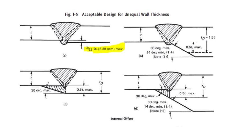

I have a 16 inch flange with a thickness of 0.500'', is it possible to make a counter bevel and leave it up to 0.375'' which would be a decrease of 0.125'' (1/8'').

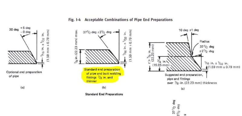

If it is possible and I have my flange thickness at 0.375", can I weld to a 0.344" pipe? I read the ASME B31.8 code as shown in the picture FIG I-4 item (B) it is possible to weld up if i have 1/32 and i have 1/32 and in FIG I-5 item (A)says to 0.09375 and I only have a 0.031 difference.
Can I do these actions?
Thanks for your help! here attached the part of the code
But why can't you just buy the flange bored to 0.344"??
If your pipe is a stronger material than the flange then this might not be allowable.
The type of material of my flange and my pipe its similar, everything is the same only different is the Thickness.
I can't buy another Flange because the delivery time is very long and we need to finish the project on January so is more easy use those flanges.
Thank you a lot
If you can get it machined for a counter bevel you can get it bored out. Any machine ship will do this for you
