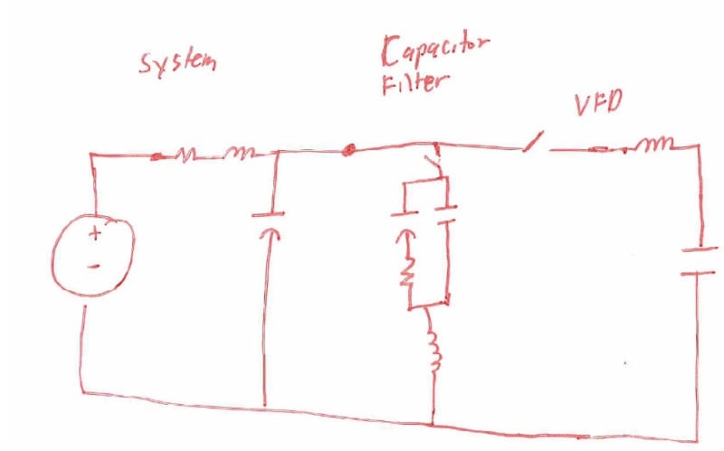

Does the schematic below adequately represent your system? As the VFD diodes cycle between conducting and blocking, they will impose transients on the system. Since the cap bank is experiencing transients, it will draw other than fundamental current. Depending upon the exact impedance values in the filtered capacitor bank, the bank can either exacerbate or mitigate harmonics.

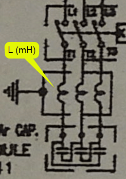

I'm a bit puzzled by your drawing above. Here is an extract from the actual drawings:
The cap has a series inductor as per the drawing above. Which is the cap with series inductor in your drawing?

On another note, you don't do the traditional calculation of a capacitor to correct power factor when you need to correct the power factor of a VFD. You filter the VFD harmonics.
Assuming the inductive load is downstream of the PFCC on a simple radial system, the capacitors will reduce VAR demand to the point of the PFCC. The reactive energy will alternate and transfer between the inductive load downstream and upstream capacitors.
If you install a harmonic filter in parallel with the source, the filter provides additional parallel path to circulate harmonic currents between the VFD and the filter hence reducing the incoming harmonic distortion.

There are several kinds of filtered cap banks; I assumed some additional RLC components to make a higher Q filter and it looks like your cap bank is a simple tuned LC circuit.
How about trying the thought experiment of treating the VFD as a constant current source in order to do a first order approximation? If so, this problem can be analyzed using the superposition theorem by do one analysis for the Thévenin60 hz source, and additional analysis for each harmonic produced by the Norton sources. Adding a capacitor bank dramatically changes the equivalent source impedance upstream of the VFD.

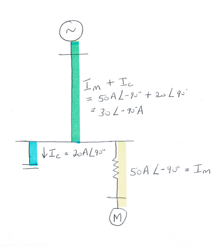

Maybe the following illustration will help:
The yellow lagging current flows from the source to the motor regardless of whether there is a capacitor bank or not. The blue leading current flows from the source to the capbank regardless of whether there is a motor or not. The NETT effect is a reduction of reactive current (and thus reactive power) from 50A lagging to 30A lagging from source to MCC (blue + yelow = green). I am more comfortable with:
But I am not comfortable with the capbank being a "source" of vars because by the same argument so is the motor if the reactive power alternates between the motor and capbank.
You are still wrongly claiming the capacitor can't be a source of reactive power because the capacitor is incapable of sourcing real power. reactive power does not equal real power.

Are you saying that the capbank with the series inductor acts like a harmonic filter? Since the capbank is in essence a tuned filter to the 3.77th harmonic, does that mean then that it is effective only in reducing the 5th harmonic and not the others?
