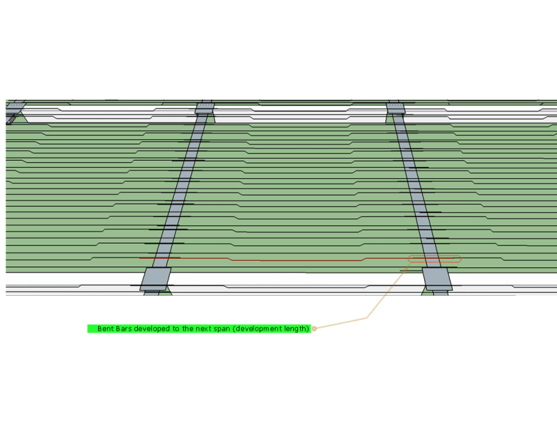

I just want to clarify what is the proper detailing of a bent up rebars for the two way slab​
and I want to know the sections of the aci code that supports it.​
the slab is 5 m x 5 m with a perimeter support beams with a width of 250 mm
the plan specs for the bars @ long direction is 12 mm diam @ 140 mm O.C BENT-UP ALTERNATE @ L/4
FROM FACE OF SUPPORT.
The following is my question :
1.) for the continuous slab, is it okey if I will not continue the bottom bars to the support as illustrated from bellow?
2.) for the hanger bars bars bars marked as yellow , is it required to continue from the top bar of one support?
3.) is it required for the hanger bars to be lapped(standard lapped) in it's termination to the bent up bars
4.) do we really need to bend bars with in the column strip?
6.) if the next slab spacing requires 100 mm O.C. how can we continue the bars from the 140 mm spacing? as I could see that the " bent up alternate bars " would be really hard to apply in this situation .
"also please correct my detailing if you would see something out of standards"
Cranking bars like that is old fashioned, and not practical anymore. Too labor intensive. Using straight bars, with only cogs at the perimeter, should answer your questions.
Hello hokie66 , I know that it is old fashion . But there are old designers that cant move on . Please enlighten me if you know. . .
I am an old designer, started practicing as a design engineer in 1970, and never did it that way, as even then it was impractical. So I can't help you.
Hello dik.. I was refering to two way slab but I drawn one direction only for simplicity . .I saw your link images..but it only refers to cut bars. Do you have any bent up bats?
Thank you for your time hokie66.

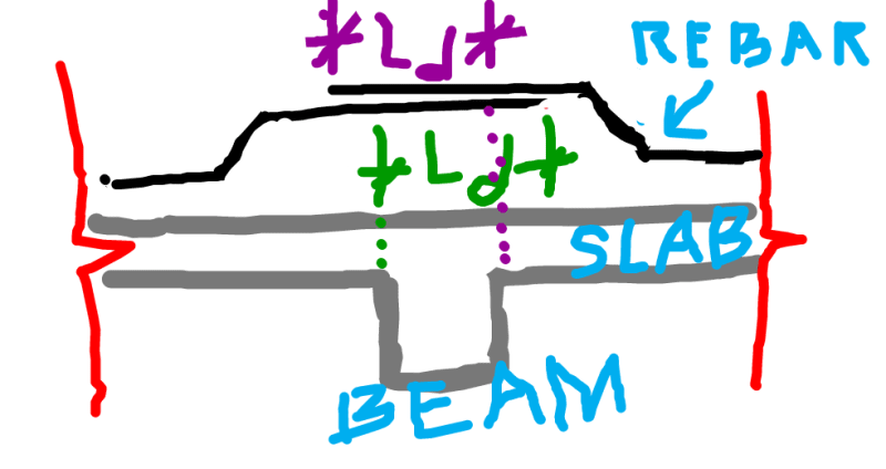

Can I ask you an opinion if my thoughts are somewhat logical.
Inorder for the bent bars to continue in its direction.. can I develop the bars at the continious support as shown in the figure. . .
No bent up bars... they were occasionally encountered with existing work circa 1970, but, have never used them.

Thankyou all For Participating . . . my thread
Hello Hoshang , hokie66 , and Dik
I was asking about 2 way slab . . I've just drawn the one direction of the two way slab for
simplification of the topic . .
By the mean of column strip I was talking of the bars parallel in its direction in which I believe hoshang is correct . .
I just want to know how do we continue the bent up bars ( where do we splice them ) for the continuous slab . . .
is it okay to develop the bars like this in the figure above (due to the limited commercial length available in the market) ?
* note that I did not draw the top cut bars on purpose to avoid confusion in my drawing . .
or it is required to alternate the bars like in the figure I mention at the start of this thread?
