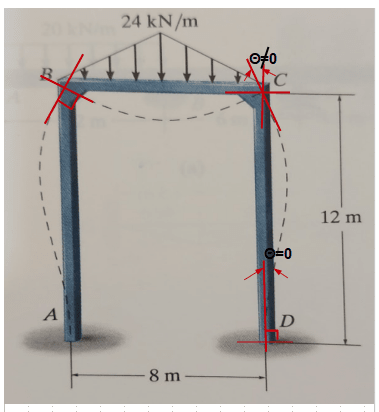

Hi all,
what is the type of joints B and C in the frame below?
Is it rigid or semi-rigid? and why?
whats is the interpretation for the rotation at these joints B and C?
Whats is the difference between fixed joints at A&D and at joints B&C?
They would be considered a rigid joint where the corner remains square even when the columns and beams flex.
The difference between A/D and B/C is A/D are also translation fixed. C/D are moment fixed but translation free.
Nodes A and D are rigidly connected to something external to the frame. The rotation is zero at A and D.
Nodes B and C are not connected to anything outside the frame. The connection between AB and BC is rigid, meaning that the rotation at the top of AB equals the rotation at the left end of BC. (Similar with Node C.)

As drawn, the connections at B and C are rigid - the members will remain at 90 degree angles to one another. Why? Because that's what the author of the textbook wanted to call them. A fully rigid connection is a theoretical exercise. All connections will have some amount of deformation, but we break them down into pinned, semi-rigid/partial moment connection, and rigid/moment connection (or any of several other names depending on where you learned them). We assume a rigid connection has no internal rotation because the amount of internal rotation that does occur is minimal and can generally be neglected in practice.
Not sure what you mean by interpretation of the rotation at B and C.
A and D are external boundary conditions. Another fiction we like to delude ourselves with. The global rotation about that joint is zero - it doesn't move and never will. B and C are rigid connections, but their global rotation is a function of the relative stiffness of the connected members. The more flexible the beam and columns, the more deflection you'll get in each and the more global rotation you'll get at that joint. The difference between global and internal rotation being that global is measured based on some fixed, external reference - the external boundary conditions, for example - while the internal rotation is measured relative to the members themselves.

Joints A and D are fixed ends with 0 degrees of freedom. Joints B and C have three degrees of freedom each, and preserve the continuity of all members meeting there (translation and rotation of all members is equal).
Joints B and C are rigid. Why? Because that is what we define them to be.
Semi-rigid joints would need a spring defining the moment-rotation relationship.

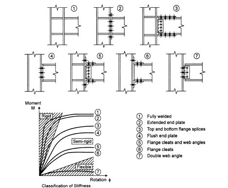

I just want to add, in real life A and D still can be semi rigid depending on the foundation rotation etc and B and C can be semi rigid depending on the connection .
One of the old methods CROSS method, i think it was good to see the relative stiffness of the connected members.
I will suggest to look ( SEMI-RIGID JOINTS IN STRUCTURAL STEELWORK Springer-Verlag ) and semi-rigid
connections handbook by W.F. Chen
The following picture depicts the concept taken from the above reference book
