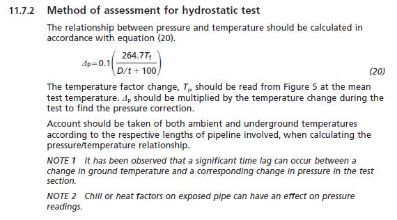

Smitty532,
That was a very measured response and I apologise if I came across a bit narky, but you never know what the background is a lot if times to the issue or the person.
I've never seen such a tight measurement of temperature on a pressure testing spec before, but what you're really after is repeatability which is sometimes quite different.
It is really the change in temperature you need not so much the absolute number.
As said before, the key issue is simply with the number of locations you can actually monitor and whether these are representative of the entire pipeline. They need to be a reasonable distance from the end to avoid end effects and buried to get the most accurate number.
Some pipelines just go through too many different soil types to get a good reading.
The post below has some good points, which include, after a stabilization period of say 24 hours, pressure up and monitor and keep water in and water out to maintain pressure and over 24 hours if the volume ends up the same then you're good to go.
The relevant bits from PD 8010 are below.
