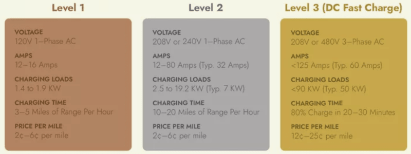

EV charger station load is all over the map -
[ul]
[li]Level 1 ~2kW[/li]
[li]Level 2 ~19kW[/li]
[li]Level 3 ~50kW and up[/li]
[/ul]
Check with the electric utility, they may have a program to provide service and chargers as a service.
A few 50 kW chargers and you have a substation.
Selecting an appropriate diversity factor for chargers is going to be a problem as they can be expected to have significant periods of simultaneous high load often enough to matter, and also periods of inactivity.
