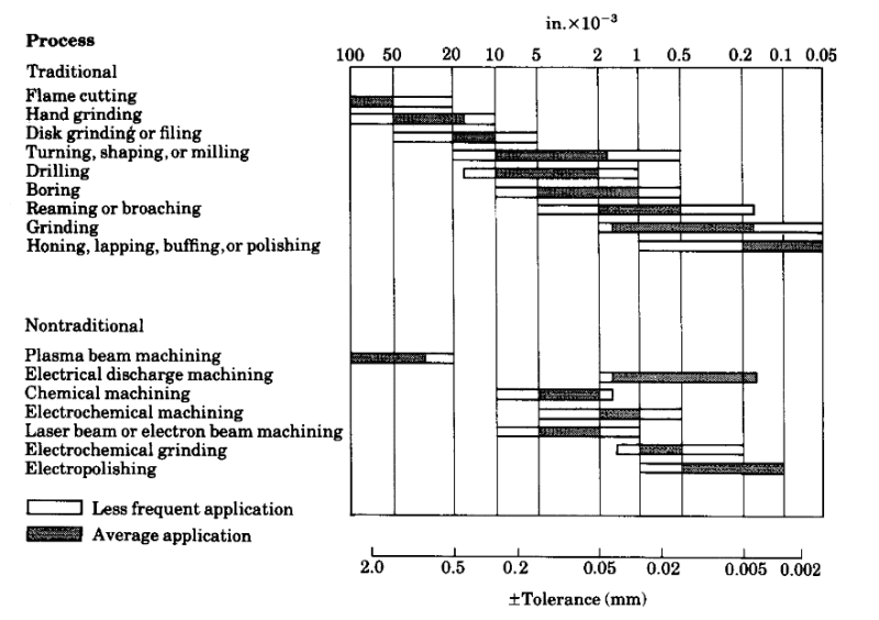

I'm also trying to get a little more generic than this specific component. What I'm looking for is a ballpark of typical values, something like what is shown in the picture below.
There isn't an exact threshold of will/won't work. It's a sliding scale of quality.
Source:
Generally, for a small pin like that the perpendicularity would be less critical than for a large pin that sticks out more. You could just ignore a projected tolerance zone calculation or just add a small perpendicularity requirement like .001 but I just think it would be a pain to inspect on such a small pin. I would just leave it off unless it was super critical. Machines are usually set up to drill pretty damn perpendicular. My guess is you'd have tight positional tolerances so I don't think the machine shop would ever try to drill these holes by hand.

Thank you Eric, ultimately this is really what I was looking for. The best solution for my problem is to use a position tolerance and use it as a datum, as described in the other thread linked below. You're correct in that the tolerance stack is primarily affected by the positioning tolerance, rather than the perpendicularity, for such a short pin.
