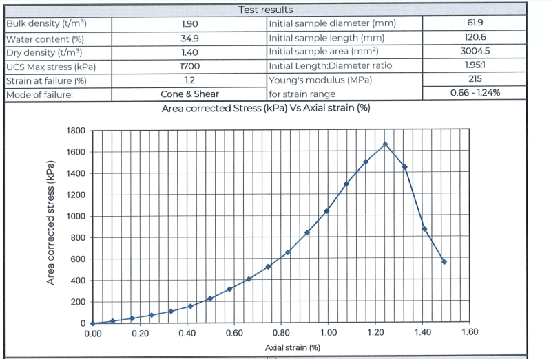

Hi all,
Hopefully a basic question. I am looking through some UCS data (image attached) and am trying to understand where the Young's Modulus has been derived from. The strain at failure is given (and a strain range) but none of these produce the Young's Modulus shown when plugged into E = Δσ / Δεa. I have read that E is calculated at a stress-strain level of about 50% of the maximum load, but this doesn't seem to yield the "correct" Young's Modulus provided either. The stress/strain are already area corrected so felt that I had ruled out this as a potential issue too.
Am I missing something, or is the data I need to calculate E myself hidden within the lab processing?
Cheers.

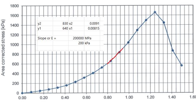

Its not stress strain at a single point, its a tangent or secant modulus.
There are many ways to determine E mod form USC, tangent modulus of strain %, secant mod at 50% of ult strength or tangent mod at 50% strength.
Yours is likely E determined using tangent modulus measured at 50% ultimate strength.
I guestimated the values so 215MPa is correct.
Also, the lab report should clearly state how it calculated it.
The report indicates the Young's Modulus was calculated for strain range of 0.66-1.24%
Thanks both, must have had a brain fart yesterday as I plugged everything in as per EireChch methodology but using their provided strain ranges and resultant stress range and it works fine.
Not sure how their provided strain range matches any of the potential ways to calculate E you list EireChch - looking through the small batch of UCS test results I received, the provided strain ranges do not align around the 50% strength mark, rather they correspond to a range between 16-25% and 100% of strength. No further commentary within the lab report.
