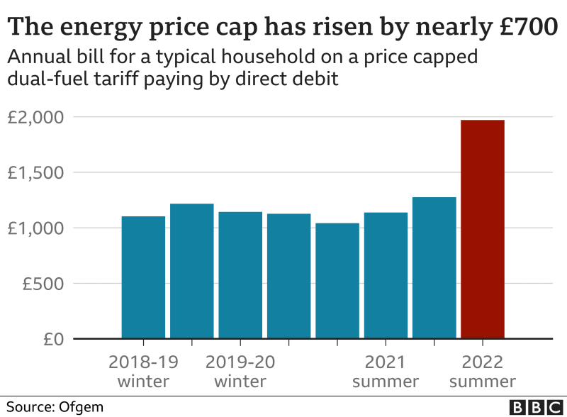

As for costs I don't know if I would call the trend extreme during the period renewables have been increasing. It looks like a roughly 25% increase over 10 years prior to the 2022 craziness we are experiencing.

Typical energy costs (mine!):
Electricity = 27.09p/kWh, with a standing charge of 48.65/day
Gas = 7.22p/kWh, standing charge of 27.22p/day
