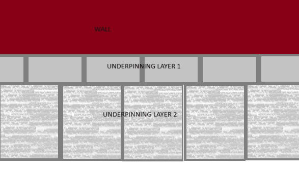

Have you ever done an sort of double underpinning? See image below.

Geoluk, underpinning should not be done in multiple lifts (i.e., underpinning the underpinning). Underpinning in multiple lifts compounds the possibility of problems and settlement ( 2 lifts, double risk, 3 lifts, triple risk, etc.). Underpinning should be performed using hand excavation, not a backhoe. If the pits are excavated too wide, you risk wall and/or foundation damage. At 5 feet deep, the excavated pits should be shored with 2x10 dimensional softwood lumber in lifts of about 4 feet or less. Check OSHA shoring requirements for excavations and confined space entry. There are plenty of threads on ET concerning underpinning of buildings and rubble stone wall. My web site has a presentation on building collapse and underpinning, including details. In addition to needing sufficient bearing, underpinning piers also need to be checked for sliding and overturning due to lateral soil loads and any existing or possible surcharges inside the building being underpinned.

Somehow it all works out. I just have to do the underpinning.
@PEinc
Thanks for your response. Somehow it slipped my mind that you'd double the settlement risk with multilevel underpinning. And I agree with all the other points you made.
