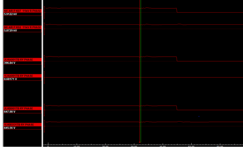

Plz see printscreen of fault recorder. 10-13 s after fluctuations in voltage 647.98 V (instead of 690 V), the plant tripped.

You said the voltage dipped to 647.98V which is hardly 6%. If so, why did the Undervoltage protection (that is set at 176V) operate??
It seems you are missing something here.
Your fault recorder appears to be showing RMS voltage. A waveform capture of an event would be more revealing to the experts here. This fault recorder does not indicate the instantaneous lowest transient voltage which might be what is triggering your undervoltage voltage protection.
