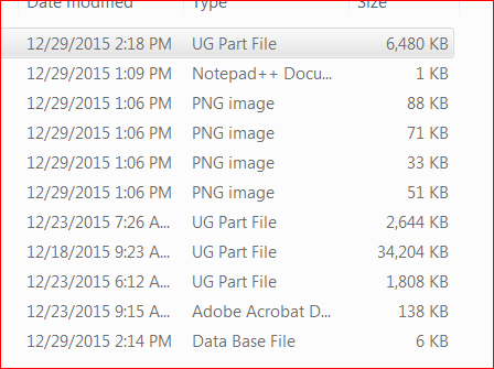

I am new to unigraphics. I created several parts and an assembly from those parts and saved them in My Documents. Then I went into the folder and copied the files to a new folder as a backup. Now when I try to open the original files I get an error message "internal error" and the part and.\/or assembly won't open. How can I get back the parts and assembly that I worked so hard to create?

What you describe should be a fully legal action to perform. - Unless you run a very old version of NX( Unigraphics) and the directories ( for this old version of NX ) contains non ASCII characters or spaces.
Try copy the files to C:\temp\ and open them from there.
If this doesn't work, call GTAC.

You can try to copy all your files into the same folder and set your assembly search options to "folder" then open your top level part file.
