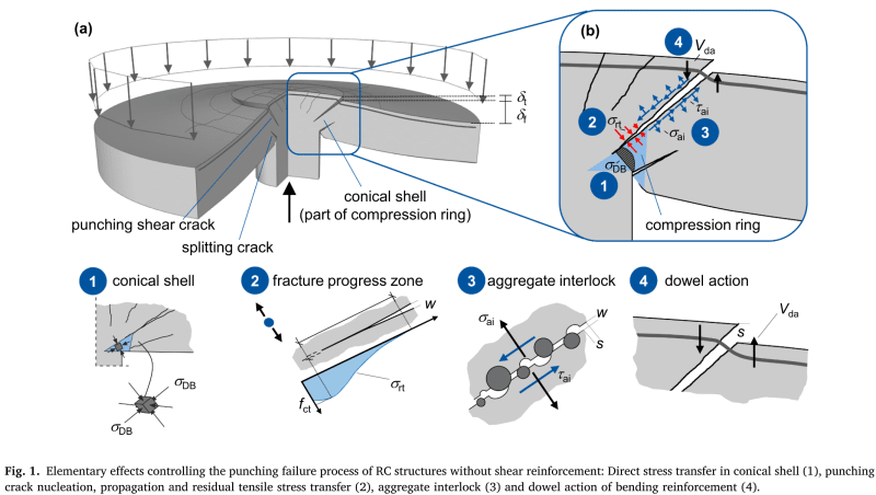

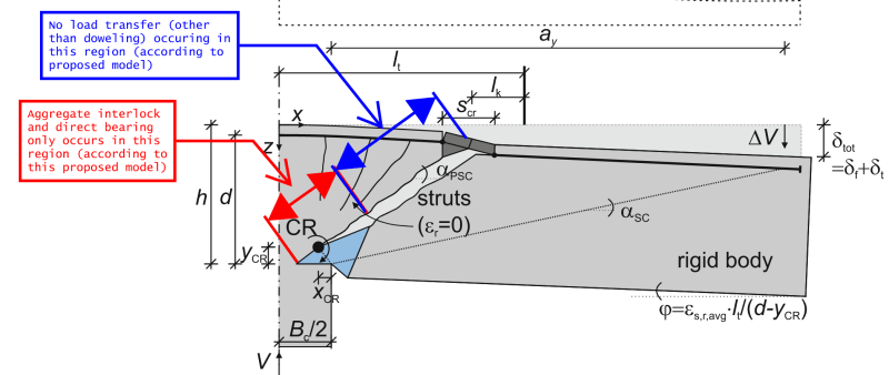

Yesterday I stumbled across a paper that further refines the modeling of punching shear mechanics and offers a fully mechanical model to predict punching capacity.
While the approach is impractical to use for typical design, it describes important parameters like 1.)what depth of the slab that is transferring shear via aggregate interlock 2.) what depth of slab is involved in direct bearing, and 3.)what percentage of punching capacity is from top rebar doweling.
In my condition, most of the force flow would be within the depth of the new, high strength concrete. However, the spalling that impacts doweling capacity is a function of the existing, weaker concrete. Since doweling is not a major contributor for my reinforcing ratios, the new, stronger f’c will be primarily influencing the capacity, almost 100% so. Even taking a 50/50 average f’c to use in design equation would still be conservative… according to this model, any way. TBD what we decide to do.
Interesting result from the above: is that if we poured a topping slab (instead of pumping under soffit), the f’c for punching should be based on the existing, weaker concrete f’c. I know of designs that have used weighted averaged f’c in the past for such situations. Good to know for future designs.

However, I am attempting to look at it through lens of CSCT (or PSRT model as I recently linked). First, realize the main punching crack initiates at as low as 20% of ultimate. It's there well before failure - its just a matter of how much it opens.
For ultimate capacity, the PSRT is not even assuming any force flow in the top of the existing slab. The existing concrete is barely being utilized in the punching mechanism . CSCT appears to suggest the same, but its not so explicit - hence I was looking for anyone familiar with it. PSRT is seemingly new (and perhaps yet to even be peer reviewed??), whereas CSCT has been thoroughly vetted and incorporated into code (fib MC2010)
