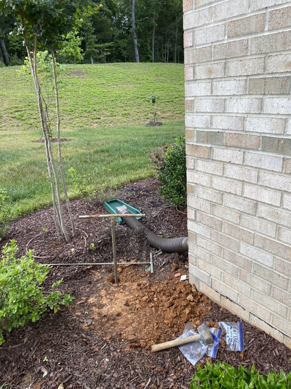

One of my field techs took this picture. The crack runs the entire side wall from front to back.
The residence is in Charlotte, NC.
Well ya better hope the builder never sees that photograph!!!!!!!!!!. The plastic trough at the end of the downspout is funnelling water back towards the foundation. That might not be the primary deficiency but it would be more than adequate for a competant lawyer , or engineer , to sow doubt.
Not to mention the fact that the high ground at the back of the house clearly funnels all drainage back towards the foundation..........its no wonder the whole house is settling!!!!!!h
