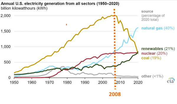

1) Start with generation. One graph tell the whole (recent and ongoing) story. Generation is changing, and it is changing really quick:
Look at the large scale changes since 2008. Large numbers of coal fired stations have come off-line since 2008. In that same time frame, pretty large numbers of natural gas and renewable have come on-line. These trends are continuing, accelerating, and expected to continue. With a trivial number of exceptions, the out-of-service coal stations are at different geographical locations than the new natural gas & renewables. So what does this mean...

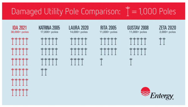

4) Distribution. The author makes a big point about the large numbers of people who have lost power for extended time. One of his links to "prove" his point shows that it is the distribution system that is out (30,000+ poles) from Hurricane IDA:
Restoring (distribution) electric service often has to be performed one customer at a time. Sometimes, throwing a switch is the answer, other times, replace a series of broken poles, transformers, and conductors... and the utility does not know in advance exactly what material and equipment will be required for any specific customer. This has to be determined on the spot then dealt with.
I love that graph. Thank you for posting it. It gives me some hope. We're making a lot of the right kind of changes. And, it's happening relatively fast. Though I know many will argue that it needs to happen faster. Also, I would argue that we should want to see the percent of nuclear energy increase faster too.
I'll acknowledge your good points about transmission too. But, I'll let those stand on their own.
Thank you, Josh. Generation changes are happening at stunning speed. This is being driven primarily by high-usage industrial and similar customers who have direct power purchase contracts with electric utilities. They have a lot of bargaining power and are demanding lower rates. Coal cannot do that. Natural gas, especially high efficiency combined cycle plants can. A natural gas plant is cheap compared to coal and can be permitted, constructed, and brought on line quickly. Emissions are a fraction of even a modern coal unit.
Yes, I have been arguing for a long time that the quickest, cheapest way to reduce carbon emissions right now was to replace coal with combined cycle natural gas. But, I didn't realize it was happening at the rate that was shown in your graph. That was pleasantly surprising.
Coal plants have been shutting down with regularity for a number of years now (and the air quality where I live downwind of the Ohio Valley has improved noticeably).
In CC gas plants CO2 is significantly reduced (but not eliminated). With a lifetime of 20 years and lower cost to build they provide a useful transition. Harmful emissions are effectively zero.
Even if coal gave zero carbon emissions, the harmful emissions (heavy metals, SO2) and the deadly practice of mountaintop blasting should be enough to ban them. However it is the economics that are working against coal - who today would make a massive investment in something with a 40-year life in such an uncertain political/regulatory environment?
