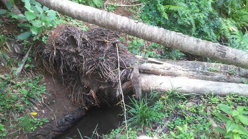

We are working on a project to refurbish a water canal which carries raw water from a small dam on a river to a water tank 7 km away. The water flows through gravity between the dam and the water tank. There is a height difference of 35 m. This is an old installation since 1888. Some parts are open canal, some parts are pipes. We have problem of soil erosion, soil falling inside the open canal, trees falling inside the open canal, people who break the pipes or canal to take water to irrigate their vegetable fields. The expected flow is around 1000 m3/hr. The water is used for sugar cane field irrigation and factory operation. Most of the route of the canal is inside sugar cane field and at some places it passes under the road where there is normal traffic.

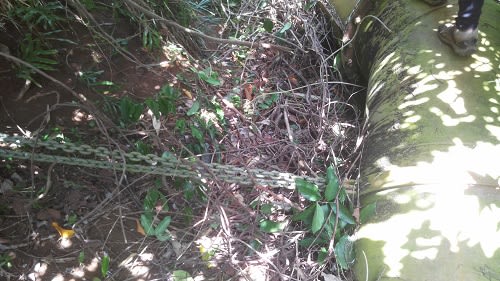

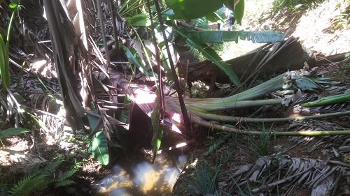

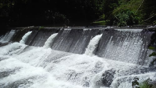

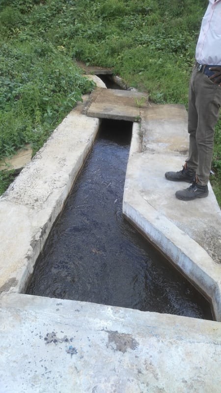

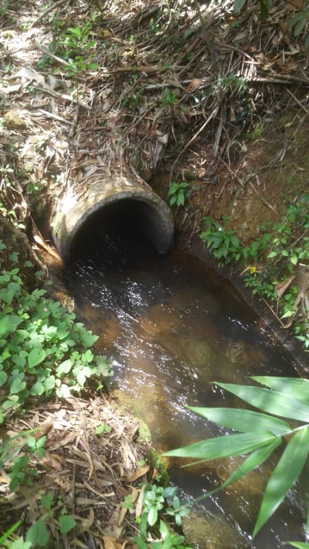

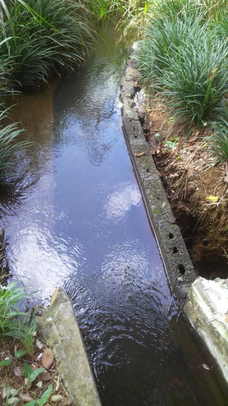

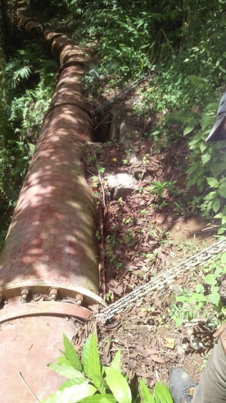

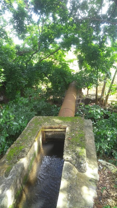

Also 130 yr old system is pretty good to last that long. Any photos?
Let us know how it goes and what you decide to do - we like feedback on this site, even if it's months later,
URL]
laisance_36_ny7u3z.jpg]
So a 20" pipe looks about right.
That's a right mixture of pipes and channels you have there....
Could you re-use some of those pipe sections and just lay more pipes inside the channel sections to tie it all together?
It doesn't look like 1000 m3/hr or is a lot getting bled off by others?
