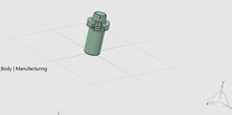

What is the use of the 2D grid in Catia V6 (3DEXPERIENCE)?
How could it be checked/unchecked?
