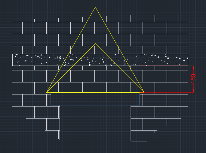

Regarding the Limiting conditions, does clause c imply that the minimum distance between the lintel and the floor above should be 600mm?
The other capture I have attached is from fig 4 of the document and clearly implies the distance could be less but it is not dimensioned.

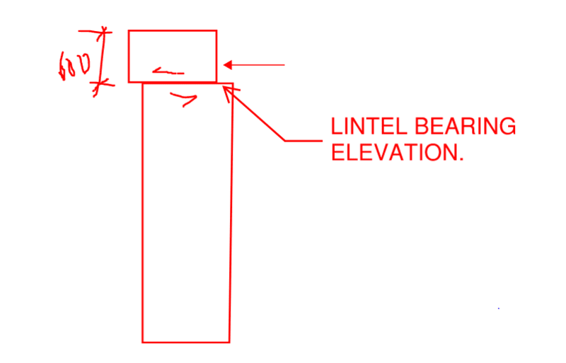

I believe the 600mm minimum is so that you have enough mass to resist the thrust. Without the mass, the lintel can't act as an arch.
I agree with it being about resistance to arching thrust but not, necessarily, that it's about mass. C & E taken together seem to speak to thrust resistance:
e) Provides enough wall adjacent to the opening such that the thrust can be resisted by the shear resistance of that wall secment.
c) Provides enough wall above the opening at the bearings such that you've physically got something for the thrust to push against in bearing before it is moved down into the wall in shear.
I agree that something ought to resist thrust wall overturning and that something may well be mass. I just don't know that these provisions speak to that given that:
1) The provisions say nothing about the overall height of the thrust resisting wall piers unless we're just assuming 6'-8" etc and;
2) For larger openings, the mass of 2' of brick alone certainly won't be enough to resist overturning.
I would say that the minimum distance between the lintel bearing and the floor above should be 600 unless you've provided a non-prescriptive way provide that same, thrust bearing resistance.
- Clause c DOES NOT imply that the minimum distance between the lintel and the floor above should be 600 mm..but one of the limiting conditions described in clause 5 Limiting conditions

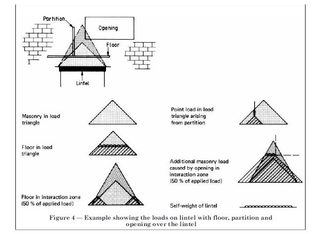

- You have posted some part of the fig 4 .. When you look to the remaining , i am sure you will get the point since pretty straight forward...I have attached below..

Pls look Appendix A Use of assessed loads for design or selection of lintels.
Figure 4 and 5 shows the dispersion of loads for applicable combinations. In case of floor load is coming from joists , pls look figure 4 point load .
